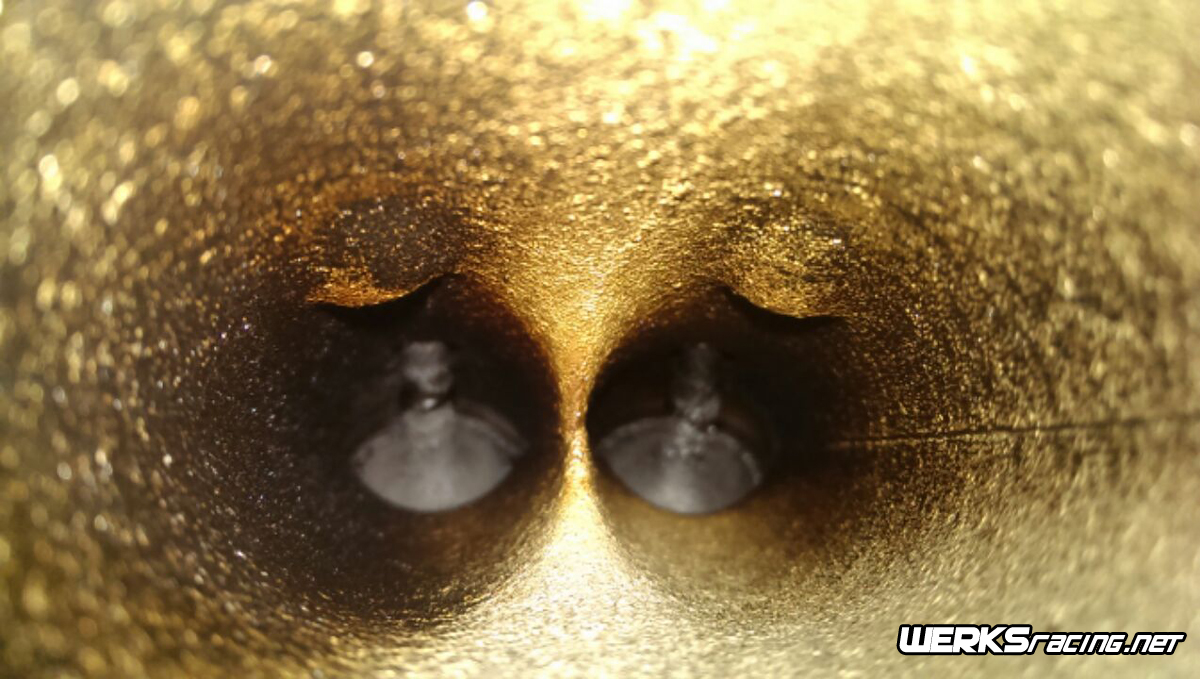

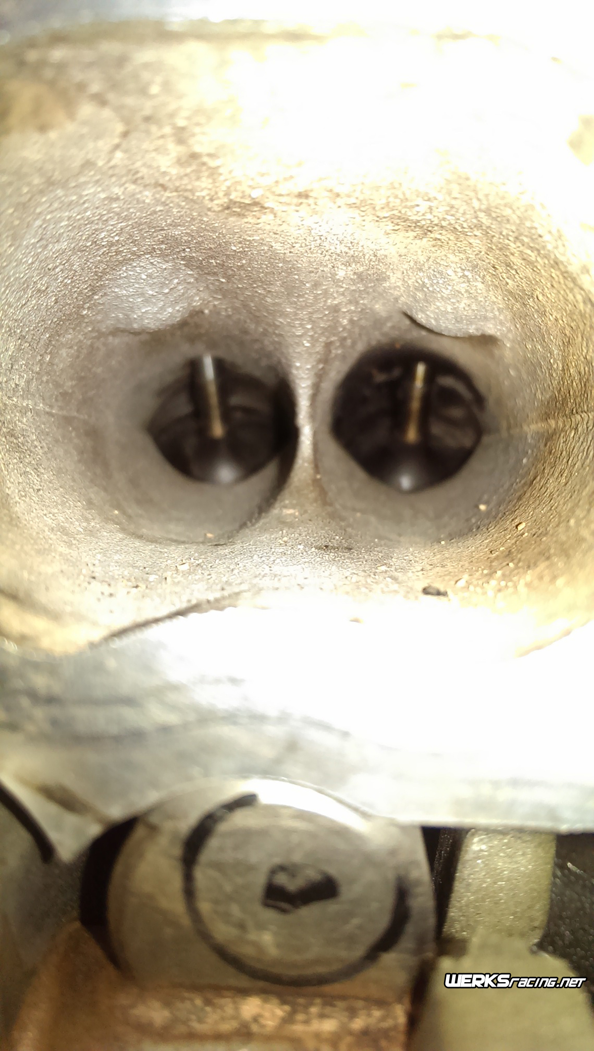

Here is a couple before and after shots -
Before -
After -

When Dave and I decided to do this I asked him to take before and afters because I didn't quite understand the whole thing. Well, these fotos are not some marketing fotos - they are from my car. Critter
