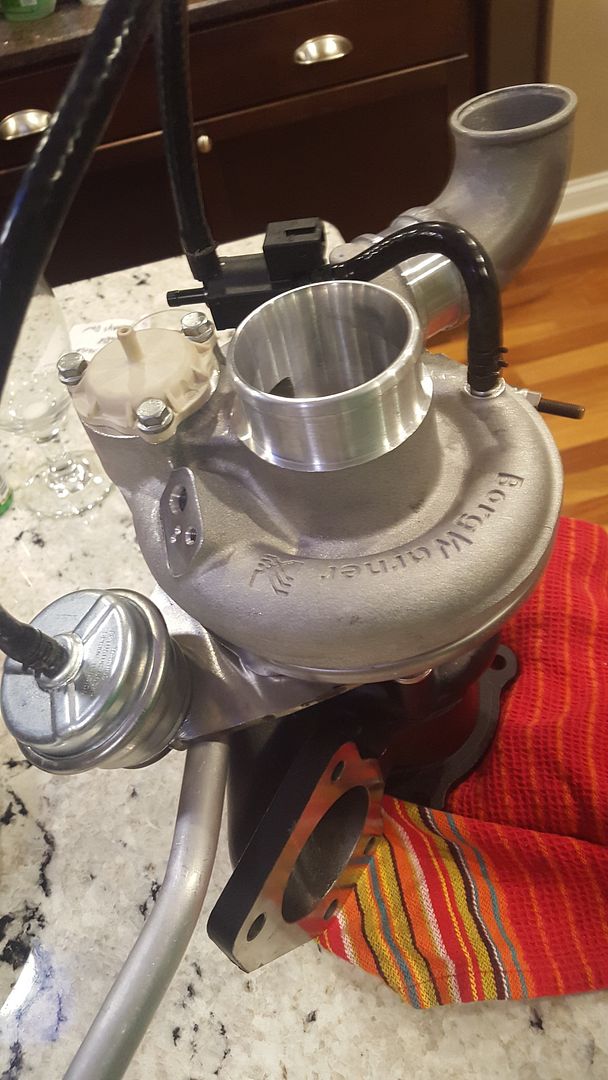

Definitely made my wheels spin when I put the WR3 on. Is the outlet welded on that you have pictured? I recently picked up a few WR3 replacement items from PAW because I will be selling my WR3 and noticed they are doing a few things different like the oil drain, wastegate bracket and wastegate adapter.

Yes the 90 ell is welded on.
this is the efr based WR3. I know once upon a time the WR series turbos were precision turbo based.
