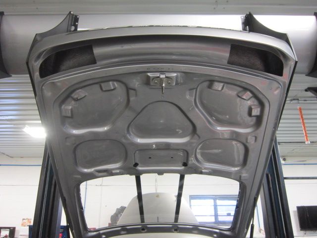

Hello, about 38lbs. less than half of stock. For some race car guys I have made them even lighter, though I dont like too for the street. Thanks again Norm

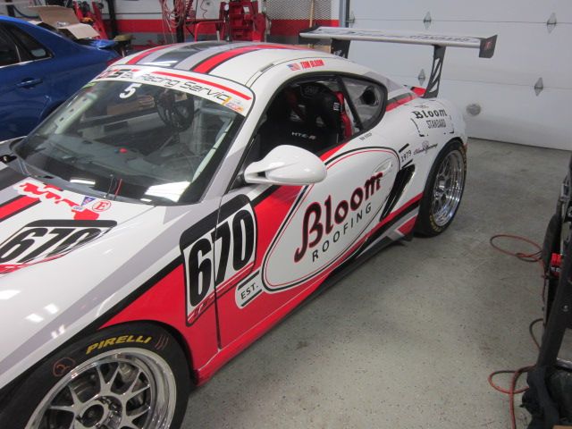

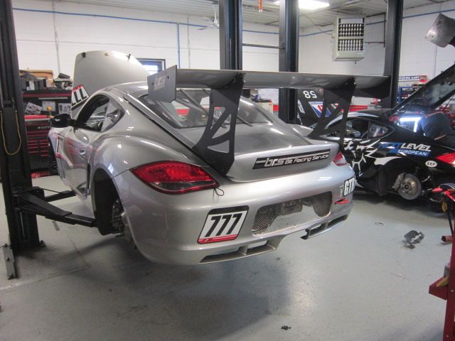

We do some, not a lot. Use C/F for the race guys mostly when they will paint or wrap. Cosmetic C/F we dont do as most of our parts are very complex in shape and dont lend itself to line up correctly such as our diffussers. For Example a Ferrari 430 rear diffusser has detachable fins which can be made seperately and the pan can be made flat across.
True C/F vacum infused parts are costly and time consuming to make, not to mention the materials are roughly three times more. Our isolthalic parts weigh not much more than C/F and most race teams who break panels dont see a real benifit to spend three times the cost for a weight saving of a couple of pounds.
Another example we build panels for Porsche Cayman race teams, doors, floors, dash, roof and rear deck lid. We make them very light strong and a lot less money than C/F.
