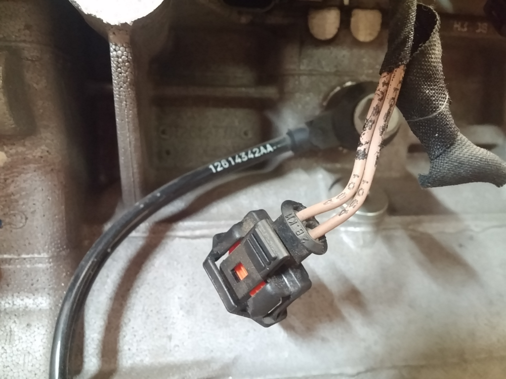

Hey everyone after going home last night and looking a my extra motor in noticed the injector wires are a tan color. does it matter which one?

Per the schematic, pin 1 is the negative side.  If you look carefully at the plug you should see pin markings somewhere (at the front or back).

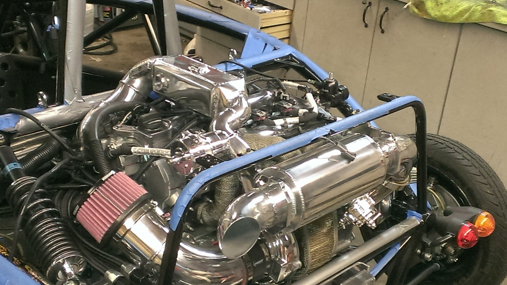

Thanks for all you guys help. Actually I don't have a Kappa,  I  have a 09 Ariel Atom 3 with a 415hp Ldk., Stage 2 cams , heavier springs 60mm Garrett with a air to water inner cooler. Tuned by ZZP If that post was directed towards me sorry about that, just looking to hook up a  new dash. Thanks . Actually where the wires come into the plug there is a # 1 and a # 2 but lll try to post a picture on Monday.

If you have a chance, I'd love to see a picture of your AA!  415 hp in a 1,350 pound car must be quite a rush.

The # 1 on the plug is what your referencing , correct.

I'll be Damned,  :thumbs: it sure is. Thanks Kelu.  Tomato soup the #1 on that plug is the one that you are Refereeing too as the switched ground?
« Last Edit: June 19, 2017, 03:03:38 PM by Atommatt »
  • Posts: 3365
Re: Tach signal.
« Reply #16 on: June 20, 2017, 08:41:16 AM »
Sorry, I can't tell for sure.  It kinda looks like a part number.  But if it IS pin 1, then yes.
Can you see a pin 1 (or A) marking anywhere else to confirm?  Like inside the injector side of the connector?

« Reply #17 on: June 20, 2017, 12:48:11 PM »
Let me double check tonight, I'll put the spot light to it this time. This forum is a little different when it comes to posting pictures. Ill figure it out .

OK, no need.  I checked the files on my computer today (I've been out of town) and found the pinout.  It *IS* the same as shown on your picture :)

Mr. Tomatosoup After taking the Fuel Injector harness a part from my other motor, I found that the 4 thicker of the 6 wires on the bottom of the main plug from the wire harness to the injector plugs are all the switch negatives.    :thumbs:

Your correct 3's do have Honda engines But sense mine had some work done on it, and it needed to be re powder coated, I figured .....What the hell lets move the mounts to make it work with a Ecotec LNF. But ended up having problems with that motor, so I bought a new LDK from ZZP .Only Atom 3 with a Ecotec in the world, Plus it's the only one with a LDK to.
415 hp  350 tq
