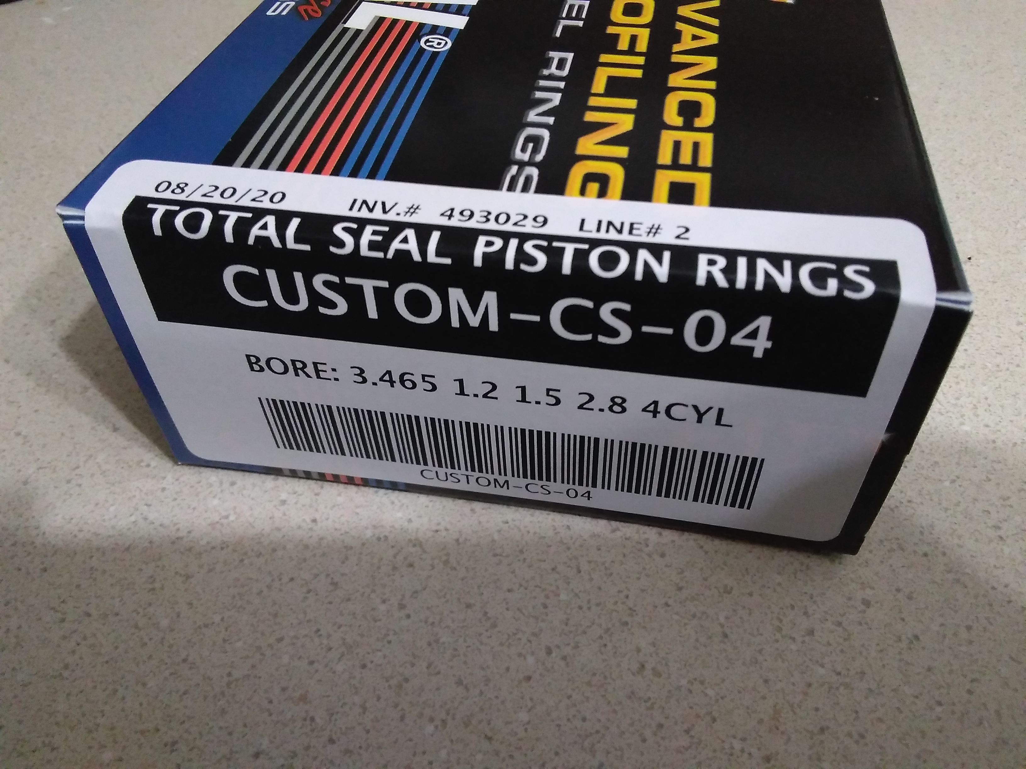

I have a confession team.  The stock used engine is smoked.  Cylinder 1 dropped and is spewing oil and I still limped it home.  Root cause is likely related to me over-boosting the stock engine (>20 psi) dicking around on woodward, just some quick transients nothing close to a full pull.  The twincharger setup with the smaller pulley is rowdy.
I take full responsibility so as punishment I must assemble another low compression 2.4 that can handle this twincharger boost.  The forged pistons from the first race engine look good enough to reuse.
Rings for the diamond pistons just showed up:
