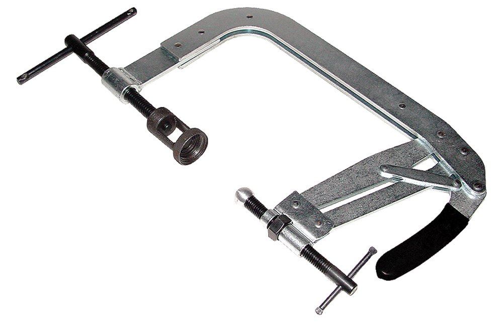

I noticed the spring compressor on your bench, that type is not ideal for an OHC.  The locking c-clamp style with the special tool/detail at the end with windows to access the locks may make it easier.  Can make your own end, I've used steel conduit and chopped it up.

Yeah it took a bit to figure out how to make it work. I still had to use an 18mm socket to depress the spring. I bought an overhead mounted compressor for the install. The official KM one is like 130 but a universal was a lot cheaper, and Im cheap. That was money spent on a bore gauge and piston ring grinding wheel.
DIY is great, the best justification to buy specialty tools  :yay:
I like the stuff pays for itself (or pays you) the first time you use it.  I think the cost of a valve spring compressor is less than the labor for an engine shop to do the same job.
