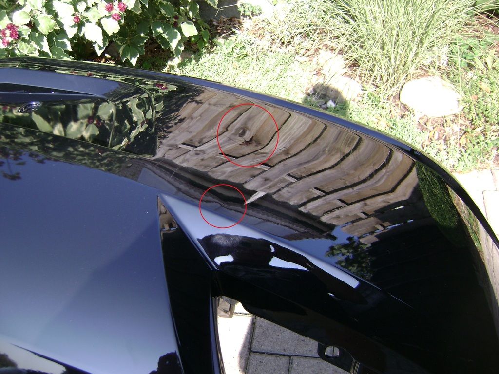

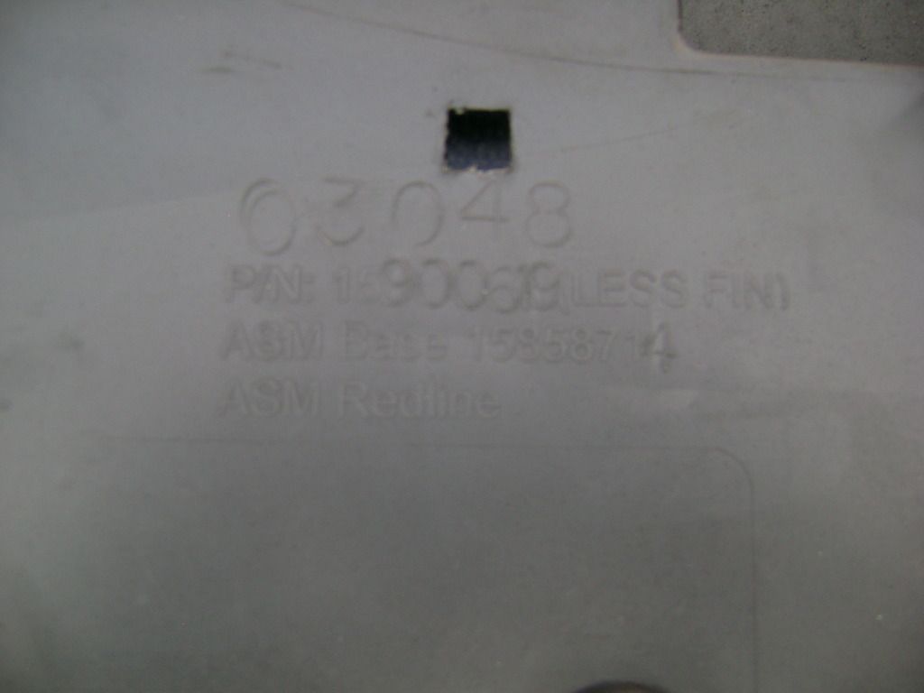

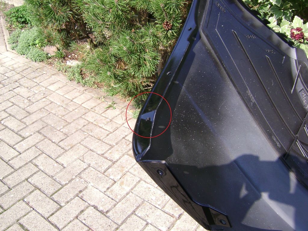

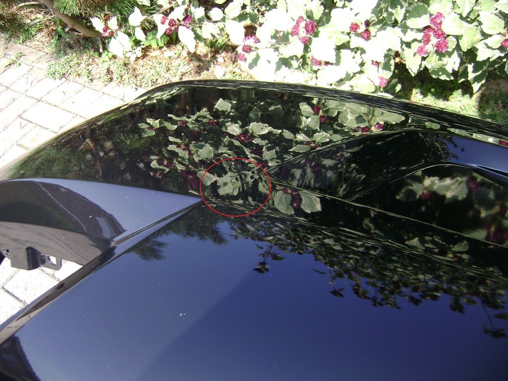

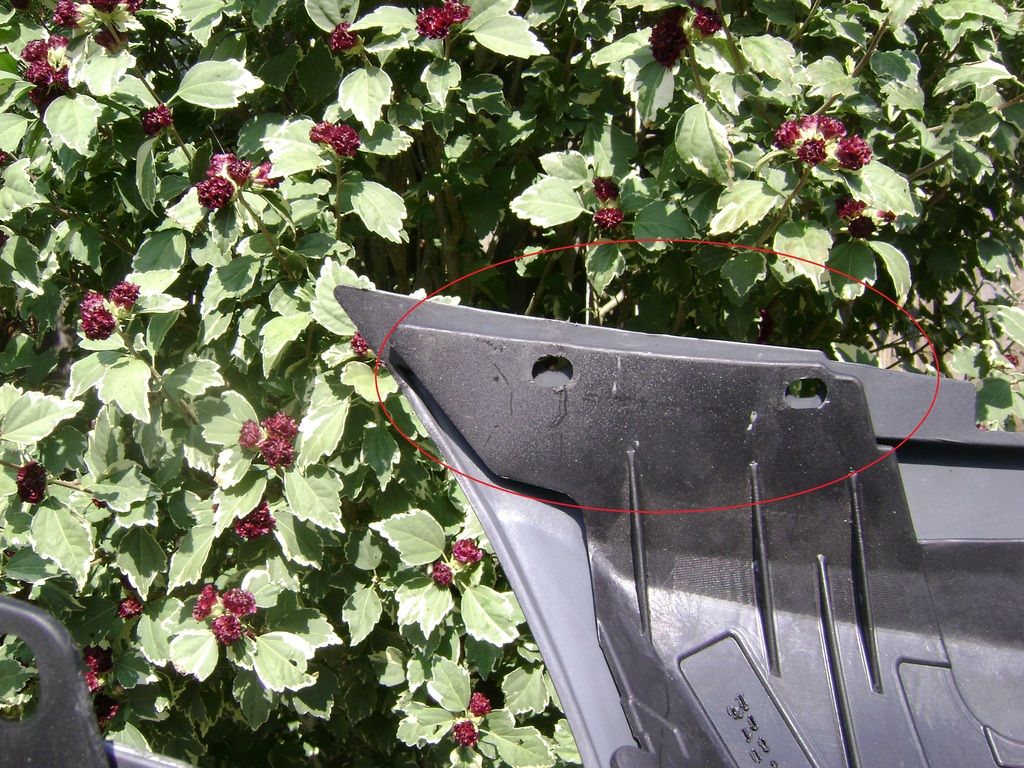

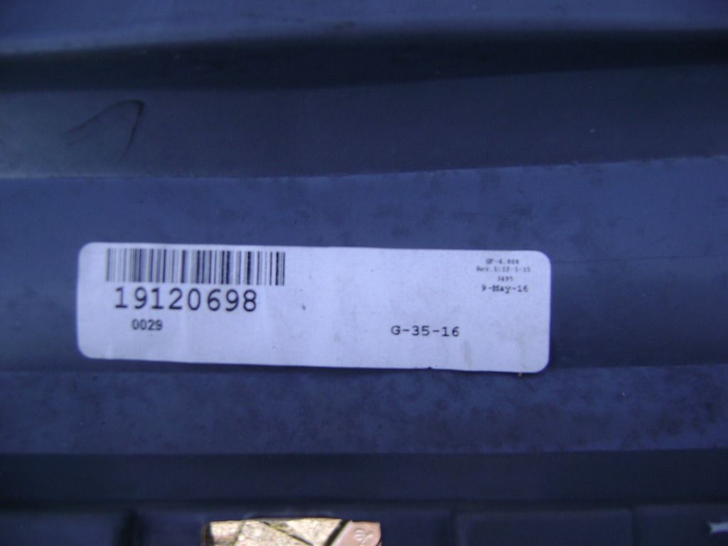

Like Kelu always says we need pictures! :(
Here a some of them.
Crooked bracket
Gap between fascia and bracket (this should be tight without a gap)
Ding in fascia from inside out and a dent
Kink
Another kink (no chance to get rid of it with hot air)
GM numbers
GM label (1 of 4)
If more pictures (there are much more gaps, dents, dings and kinks) are needed  I got a lot of them.
