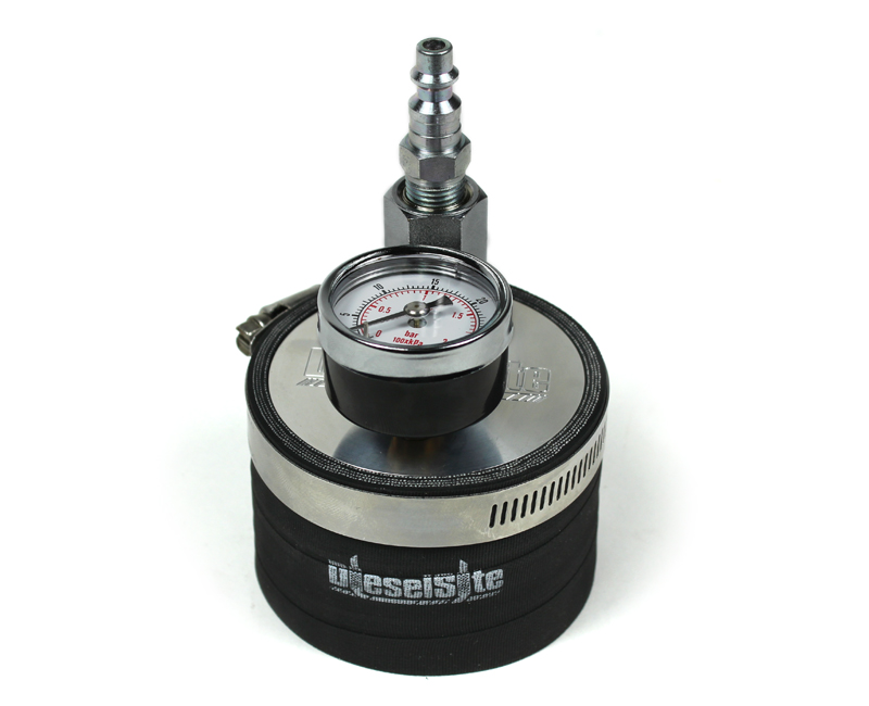

It also sounds like you may have a leak.  I had issues in the past with the couplers that connected the IC Pipes to the intercooler.
You can use something like this  and hook it up to the Passenger IC pipe on the Turbo end
