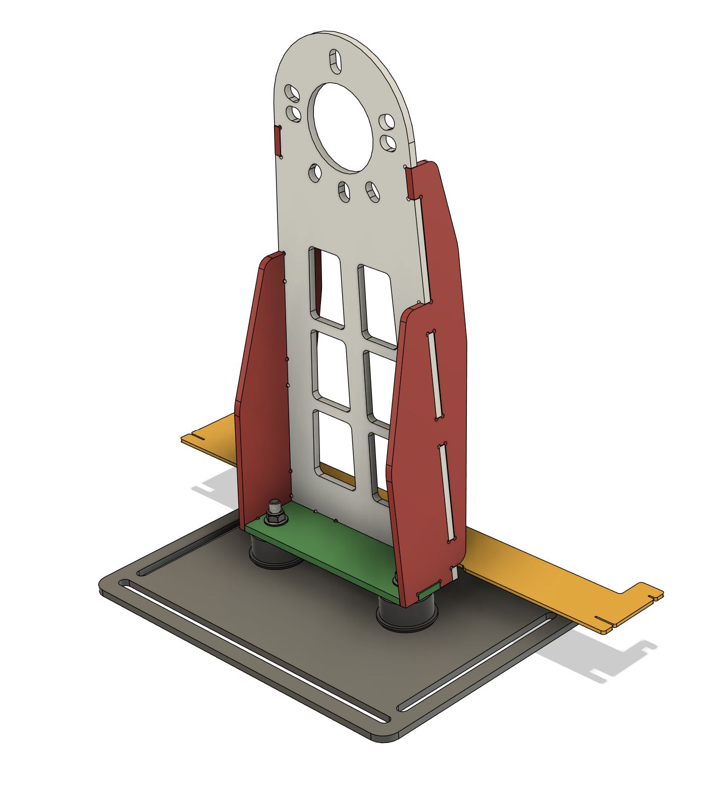

Designed this in fusion, will get a quote on getting it laser cut.
750 lb steel ball transfer each so 1,500 lb capacity per corner. I think there is diy weld together hub stand kit for $535 + shipping from turtle lab.

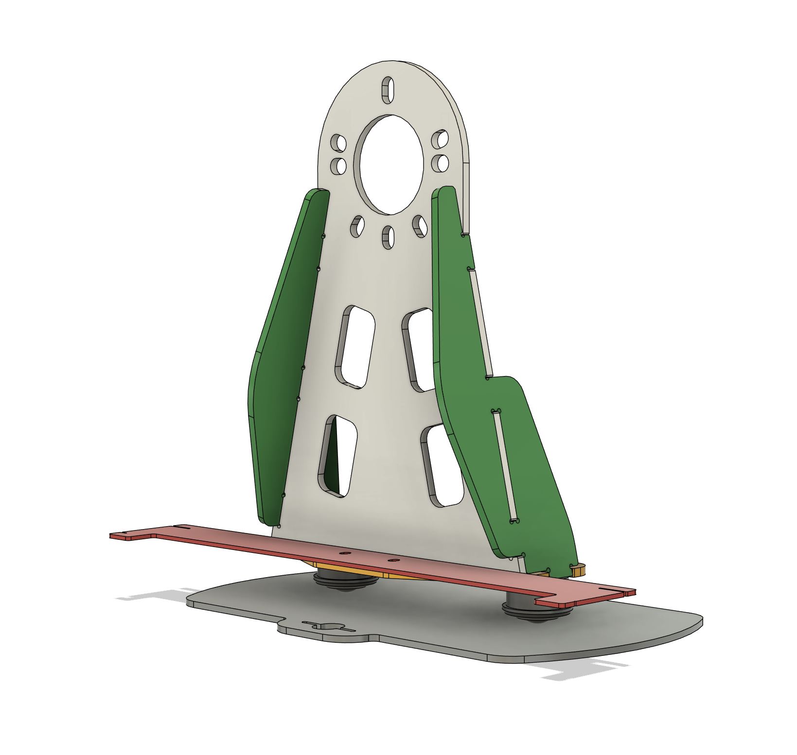

« Reply #2 on: January 11, 2025, 07:28:46 PM »
Next concept from scratch, shortened it and made it stout and tried to reduce weight, so more cut time in processing:

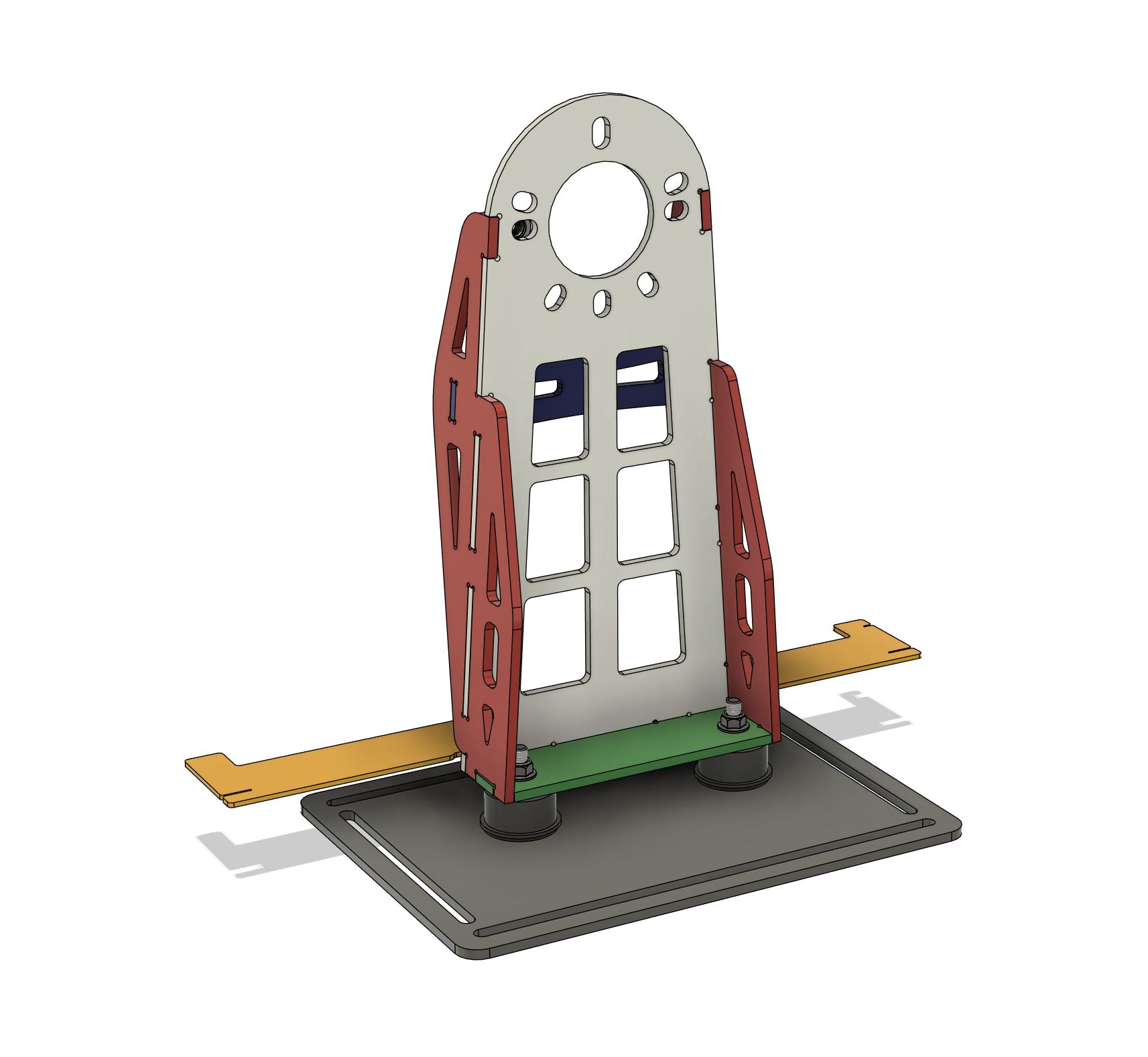

« Reply #3 on: January 11, 2025, 07:38:50 PM »
Third design from scratch.  This time I set the distance between the center of the hub to ground is 13" / 330 mm radius, a 26" diameter tire diameter proxy.  The transfer bearing contact point is set to the offset of my wheels at +45mm, and there are extra holes to set it to +25mm.  This reduced height while going to an 8" / 200mm bearing width making it more stable longitudinally, while I tried to keep it simpler to reduce cost by -$150 using sendcutsend.com to get a quick estimate.  Bolt patterns, for 5-lug: 105-115mm and 4-lug: 100-110mm. Center bore is 72.7mm to go with my Solstice wheels at 72.6mm, so I can use my hub spacers.

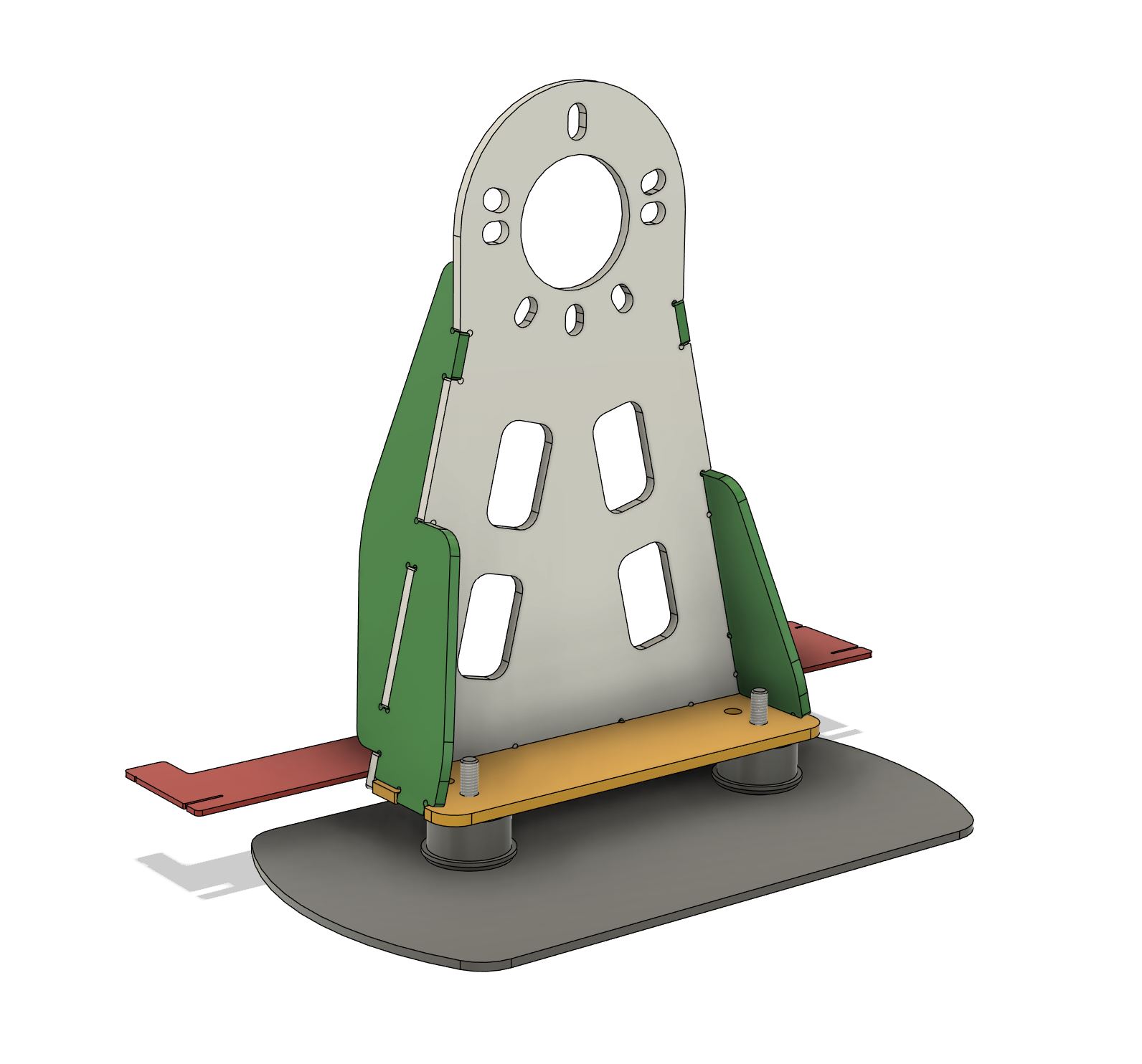

Updated universal hub stand pattern.  4-lug 100mm to 114.3mm, 5-lug 110mm to 114.3mm with 12mm and 14mm stud sizes depending on bolt circle diameter.

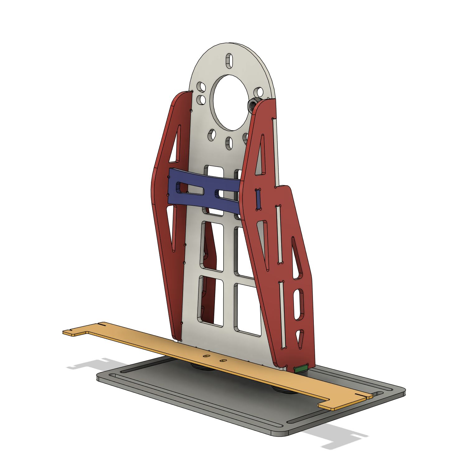

Another point about these hub stands, been throwing around ideas for the base plate that the rollers can roll on (better than my floor), where I'd like to have some way to stop the rollers if the car were to slide off the plates as a safety feature, you can see I made slots with no bridges around the edge of the plate for the ball rollers to fall in, however not too aggressive I'd rather have the car keep rolling vs. tipping the hub stand over, as my logic.  Also, cutting out a piece of a thicker material could make a wall around the perimeter of the plate, maybe a piece of wood with some girth, another part added to the mix I'd like to minimize if possible.
I don't like this design of the plate as is, it's just my last design iteration of trying to integrate a way to stop the rollers without creating more parts.
  • Posts: 10378
Re: Hub stands aren't cheap
« Reply #15 on: March 30, 2025, 05:39:16 PM »
Why don't you just stack two plates, bottom one is flat top has some circle cutouts?  Bolt or weld the two together and you end up with an easy curb design to limit travel.
Another idea go to the store and find a heavy duty cake pan and just use that.

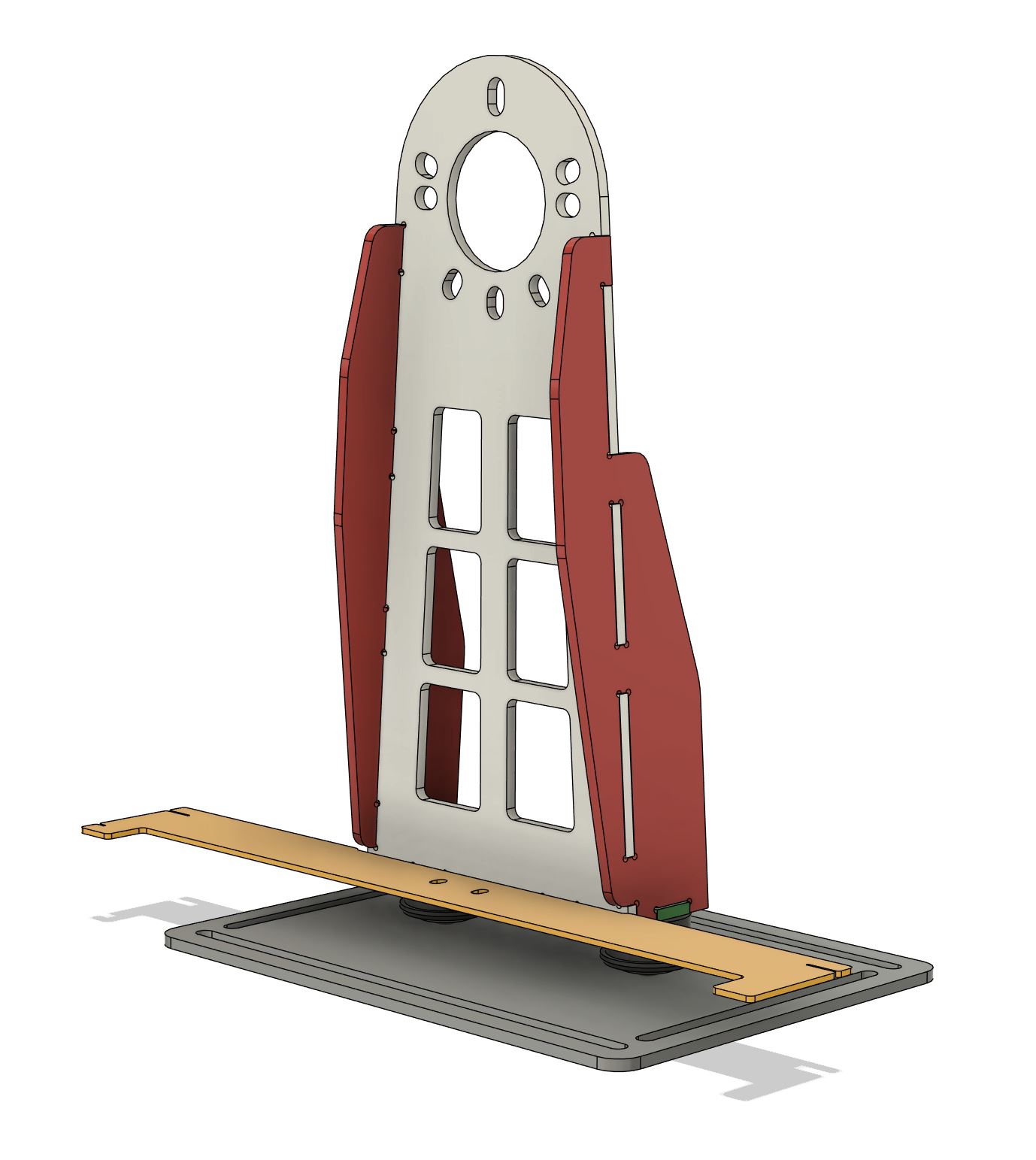

I did a little redesign to add more clearance to clear the big calipers to check the caster angle, the original design may have been okay however worst case I just went full lock with the wheel, so that last design was interfering with the caliper mount.
Should have posted this on April 1st implying I was making these out of wood hehe.  These are just 1:1 parts to check fit before commit, using 0.200" wood.  I'm planning to use 0.250" steel for the structures.
