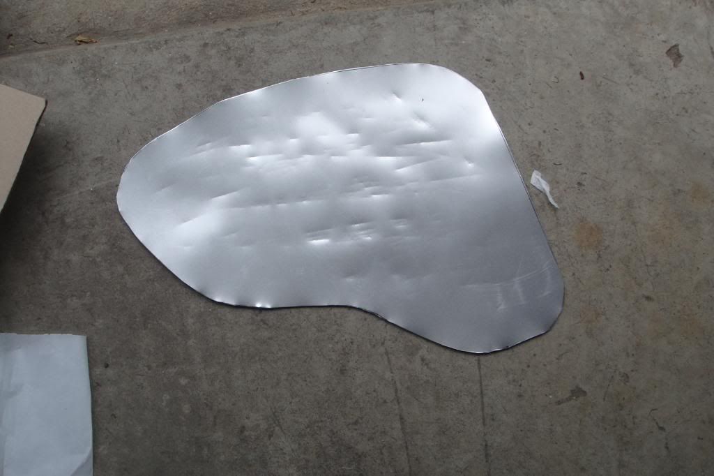

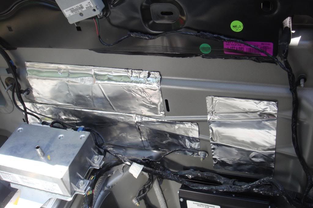

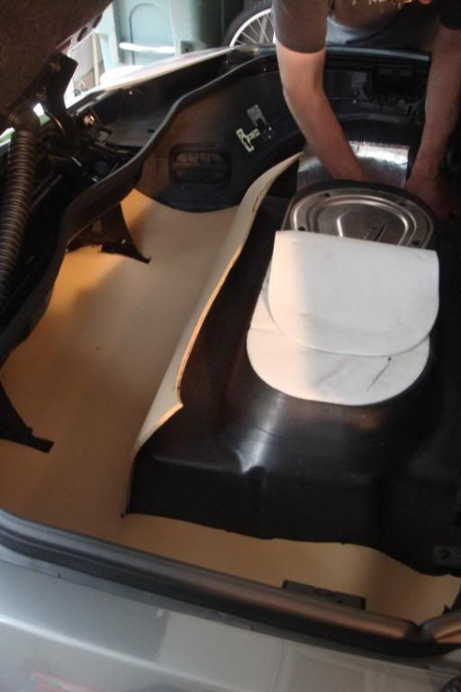

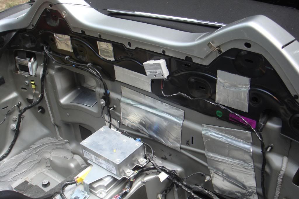

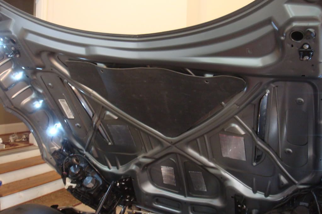

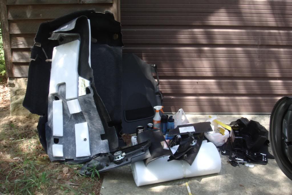

Here are some teaser pics - the silver squares are the CLD deadener tiles, the black stuff is the heavy stuff - vinyl sound barrier, the beige stuff is the nitrile closed cell foam... (May have to scroll left and right)
Don - the man, the myth, the legend...

Check out the teaser pics I posted above - the doors take the dampener pieces on the inside of the outer door panel, then he fabbed a double layer of aluminum (aluminum flashing from home depot (i have some left over) to cover the large hole in the door sandwiched with butyl rope, then the vinyl goes on, then the foam.  Remove and throw out the egg crate and the plastic sheet. Doors are much more solid now.
