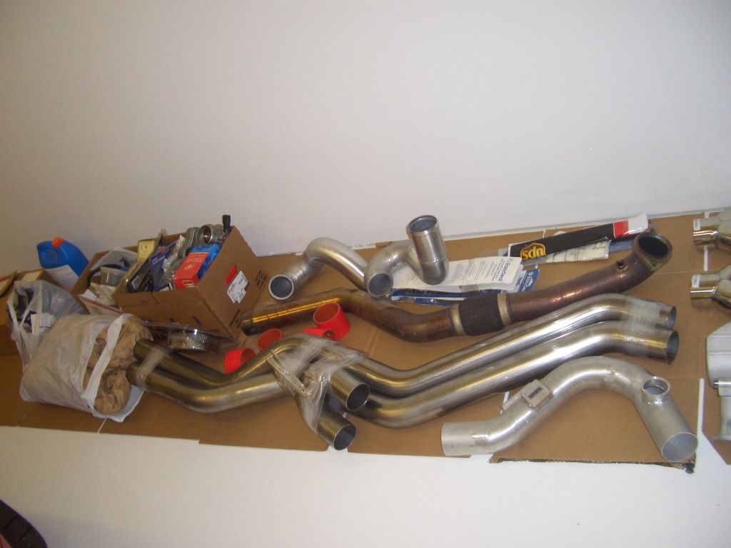

Not much happened today due to us finding out that the car will be FEATURED in a Magazine! :)
I'll keep the name of the magazine anonymous though, sorry.
so BTF decided to polish the raw stainless steel pipings of the compound kit the whole day today.......so they will look purdy for the camera.
The official camera guy of the magazine came in the afternoon to take some photos of the build.
So basically today.........other things that have been done were relocating of wirings, power steering, etc.......
An hour ago, BTF started assembling the compound kit.
Tomorrow install of the kit will begin.
anyways here are some photos:
Exhaust Manifold
hot pipe from small turbo to big turbo that has the flange for the 60mm wg and 38mm wg
4" downpipe
GT4294r and GT2871r turbos
BTF started assembling the kit
Exhaust Manifold connected to gt2871r with the 60mm wg
gt4294r plugged to the kit
installing the big turbo..........and the cold pipe that attaches the big compressor output to the small compressor input
Kit is fully assembled by BTF:
