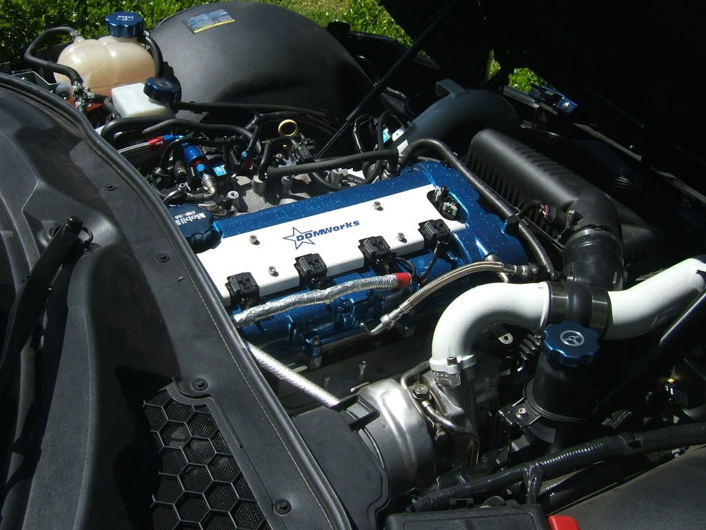

Here's mine. Continued thanks to Deepbluegxp. He can tell you what he uses. He did an excellent job.
Re: Painted Engine Cover
« Reply #7 on: September 30, 2010, 12:41:57 PM »
I used standard auto paint for smartin's, mine and deedle's.   Heat resistant paint isn't required.  Use your imagination and have fun.  Post pics when you're finished.
