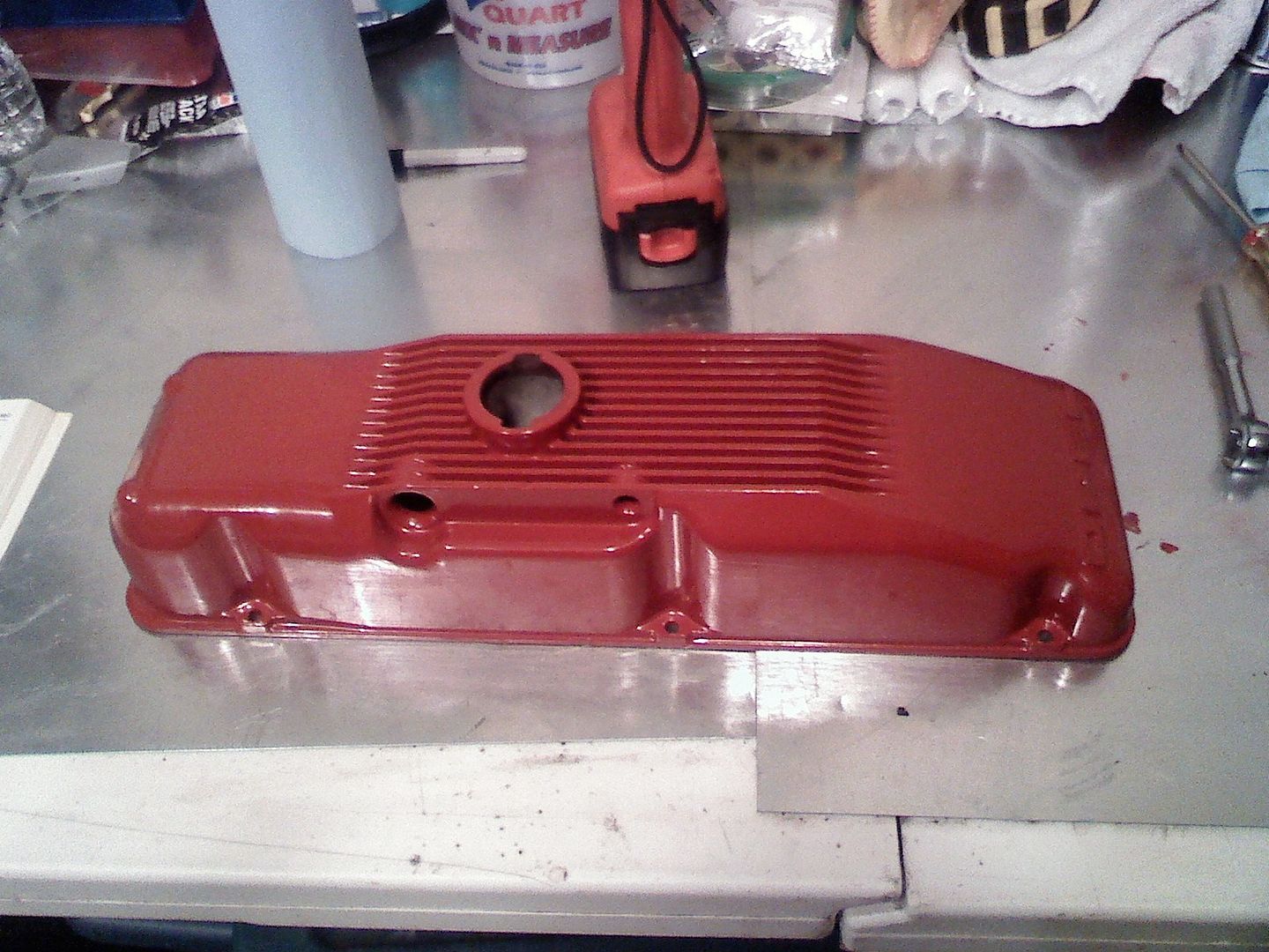

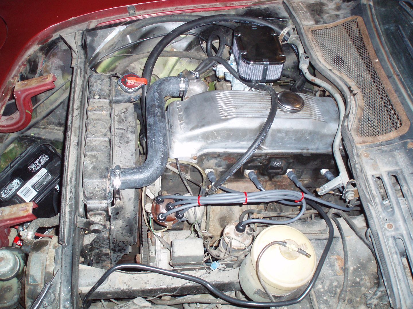

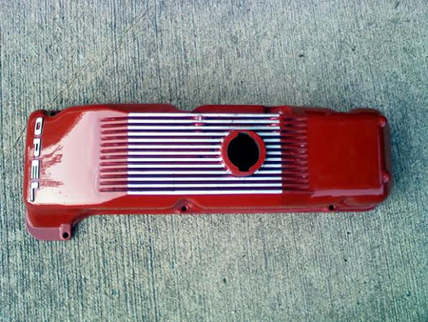

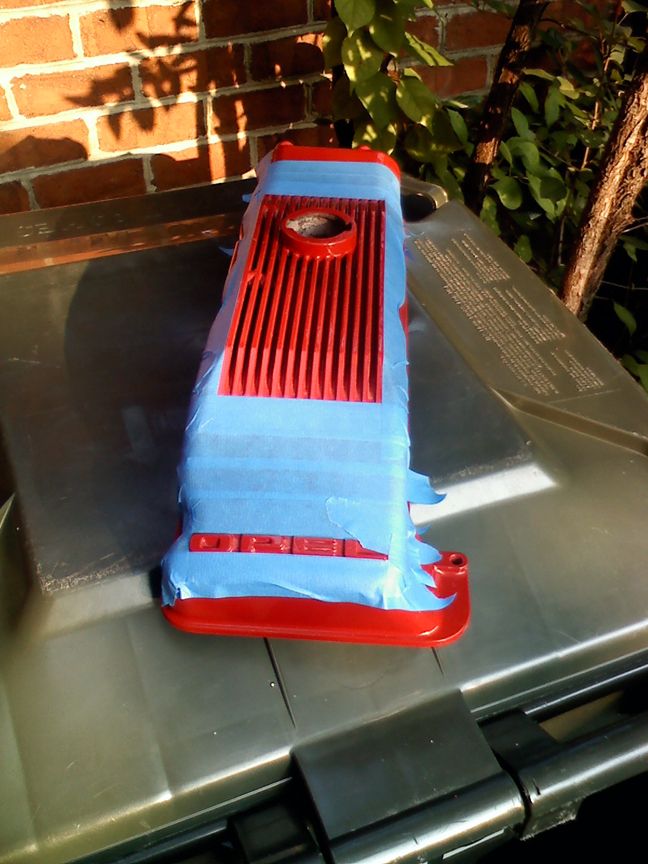

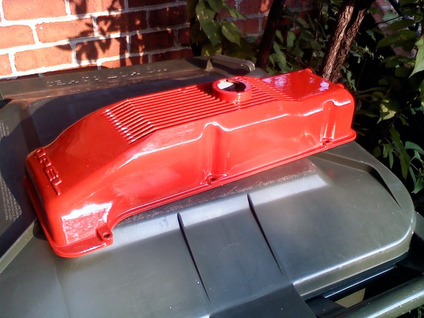

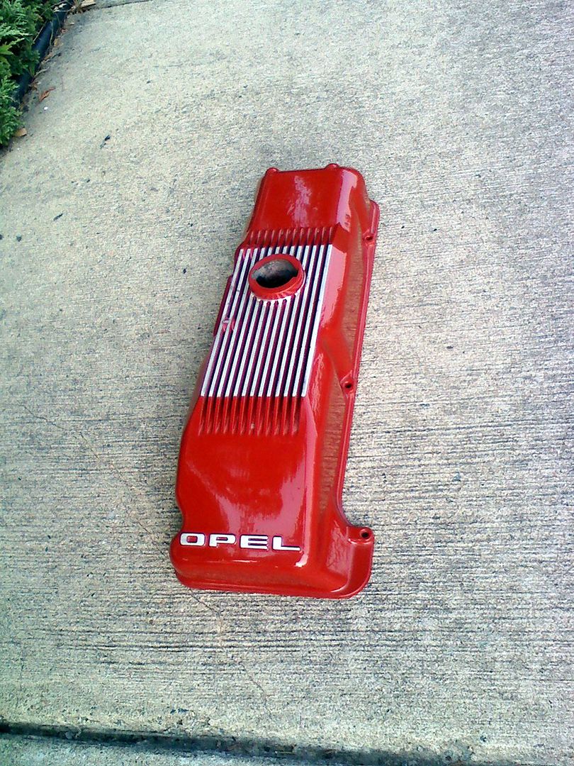

Just be very careful what you clean it with. I use denatured alcohol because it doesn't eat plastic like acetone and some others, and it removes excess oils like Armorall. Make sure you clean it VERY good, several times, or you will have a lot of fish eye.
Post photos of the finished product!
I did it on my Opel GT, old style.
Started like this:
Then clean clean clean.
Then coat with paint:
Then sand and clean again, then paint again:
Then tape and sand:
And polish to a shine:
Jim :cool:
