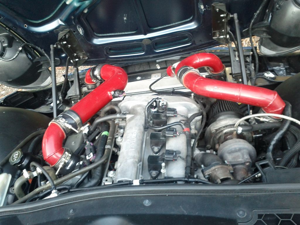

Here is a picture of the set up installed in Jinsuko3g's Car:

Filter element directly on the turbo. Where did the MAF get relocated to?

Looks to me like the Maf is on the cold side charge piping up front, you can see it in the picture. I know I'm not a fan of the filter right on the turbo either so I plan on finding an intake that will fit or just building one myself...

Good luck with the install. I have a very similar turbo[Albiet a hybrid] in my 2.0 and it pulls really well.  You should be very happy with the results
By the pic, I would look at doing something like the K&N intake for the 2.0L. Which would take you from the turbo, under the passenger side charge tube, up over the radiator and then filter in the front of the radiator shroud.

Yes, I was thinking about using some sort of cold air intake that was made for the 2.0L. I just have to see what the difference is between the diamter of the tubing and the turbine inlet as well as make a block of plate for what I am assuming is a MAF in that picture. But that is what I was ultimatly hoping to do
When you go to install the turbo, I would suggest to move the MAF to the drivers side charge tube like in the picture. The reason is that while tuning you will be able to measure the post intercooler temperature and tune accordingly. Another benefit of the MAF closer to the engine is on the 2.4L you will get a better response from the MAF during transitions.

I intended on using the MAF location that was already in the charge piping and making a block off plate for the CAI when I eventually get it, this is probably gonna be a long process though, I'll probably even tune it down to around 270HP to try to make the stock clutch last until I can get a good aftermarket one
