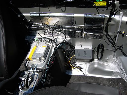

Here are some pics of the GPS (and Sirius when it arrives) antenna install Position.  The first pic shows where they are installed.  The other pictures are taken looking down from there.
Trim pulled back showing location of antenna:
Here is the little "shelf" that works out perfectly for the GPS antennae.  I have an almost full signal according to the status bar on the radio.

And here is a clearer shot of where I have the antennas installed.  The reception is better in this location than it is in my Jeep (antennae is on the hood).  Works great and I have had no issues with the unit while driving around today.
This install would have taken less time if I would have waited, but I'm impatient.  Right now everything is working 100% and I am very happy.  There are a few quirks with the Sirius adapter, (memo only works for songs not artists, and only 1 line display of info) but they are minor.  Right now I have the bluetooth adapter tucked into the far right corner of the dash, to the right of the glove box.  I may velcro it to the side if I see it is moving around, but right now it seems stable.  The microphone wire was sNAK3D across the dashboard and up the drivers side windsheild pillar.  I could figure out no great mounting options for the microphone so I taped it into the cutout for the onstar microphone.  It seems to be working just fine and the people I talk to on the phone say they can hear me without problems.  The bluetooth was easy to set up and I was able to transfer several of my contacts at one time over to the unit.  I still have to read the manual to see all of the options and settings, but it's working and that's what's important.
All connections for constant 12v were made at the radio harness, (blinker relay, Sirius, BTB200)  I am quite happy and hope that my instructions and tips here make things easier and more understandable for others.  The Speaker and amp upgrade will come at the end of the summer (as long as no other catastrophes come about first).

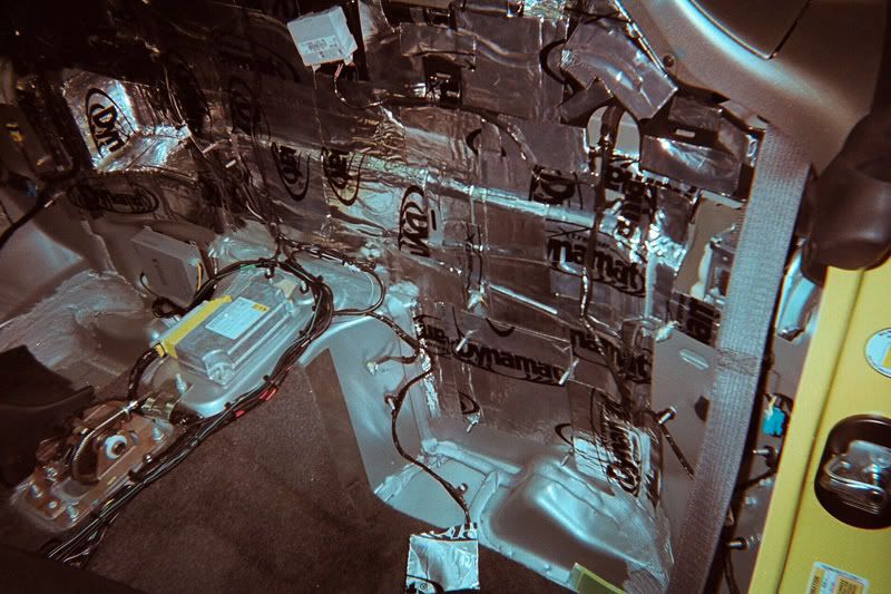

Chris my installer doing his custom thing on the amp rack:
Behold the wonderful devices that make my ears happy the JL Audio ZR series components ($800) and worth every penny of it.
Dynamat installed:
Dynamat on the doors as well (new speakers installed in factory location):
Even more Dynamat (check out the slick crossover mounting position)
I am very happy with the quality and sound of my new system.  I can't wait for the subwoofer to be released so I can complete my system.  The bass response is tremendous even without a sub.

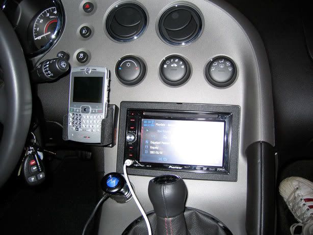

I would like to add that the Kenwood DNX 8120 is another killer option for upgrading the stock radio.
I took a much easier route for my installation.  I handed money to a much more skilled person than myself.
End Result
Kenwood DNX 8120
Integrated Garmin GPS
I have the GM Lan interface
Steering wheel control interface
IPod  cable interface in Glove compartment
HD Radio Upgrade [I'm not a fan of XM or Sirius]
a second USB port in glove compartment
GM Roadster Subwoofer kit consisting of a
      Stock Sub Enclosure with Kicker Competition Sub
      Alpine Amp
I also have a PS2/3 Cable hardwired to the AV1 port
I love it.
