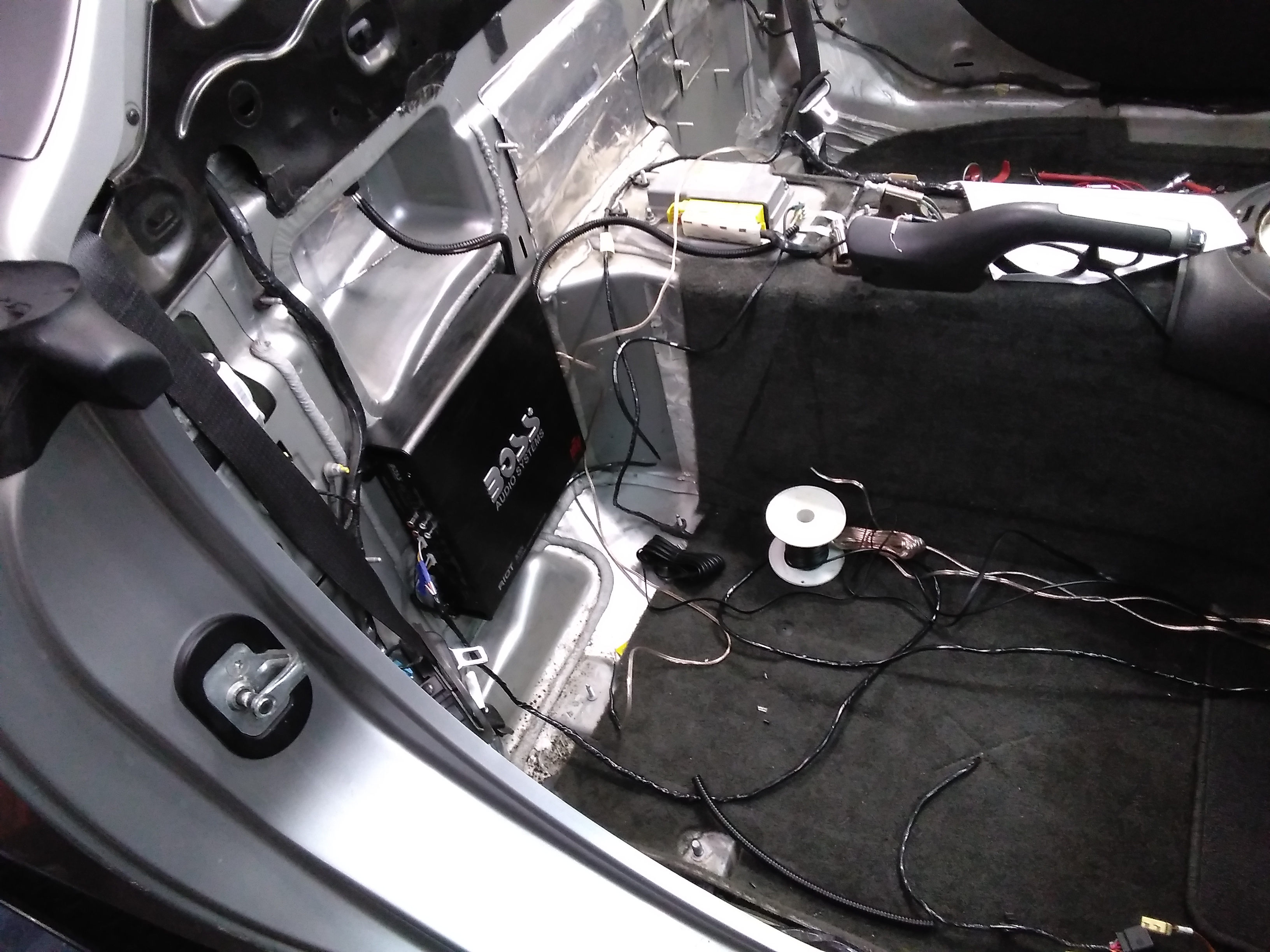

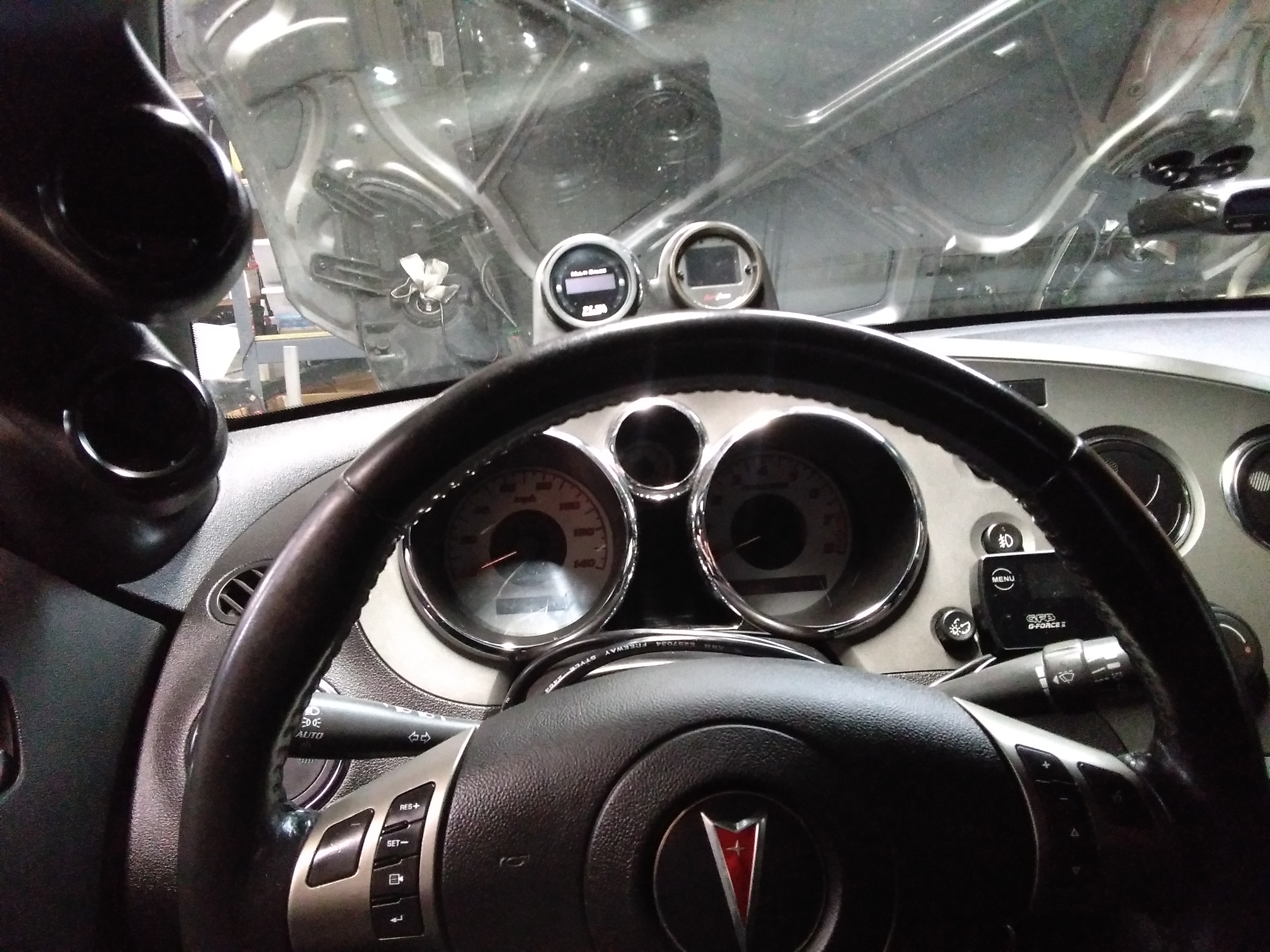

TC boost and SC boost gauges on the pillar because twincharger, PLX and Aeroforce in your face:
Had the sound system since last year, figured while I was doing the gauge install may as do this. Upgraded 4 speakers and a 1000W 4ch amp.  It's cheap boss audio value equipment, but sounds good enough for me so far.  I also installed a Taitanium bluetooth touch screen radio and got the wires run for a backup camera.
This took about 4x longer than expected (gauges and sound system). When I was younger I did stuff super fast but half-assed, these days it's takes me forever to do things because I do it quarter-assed.

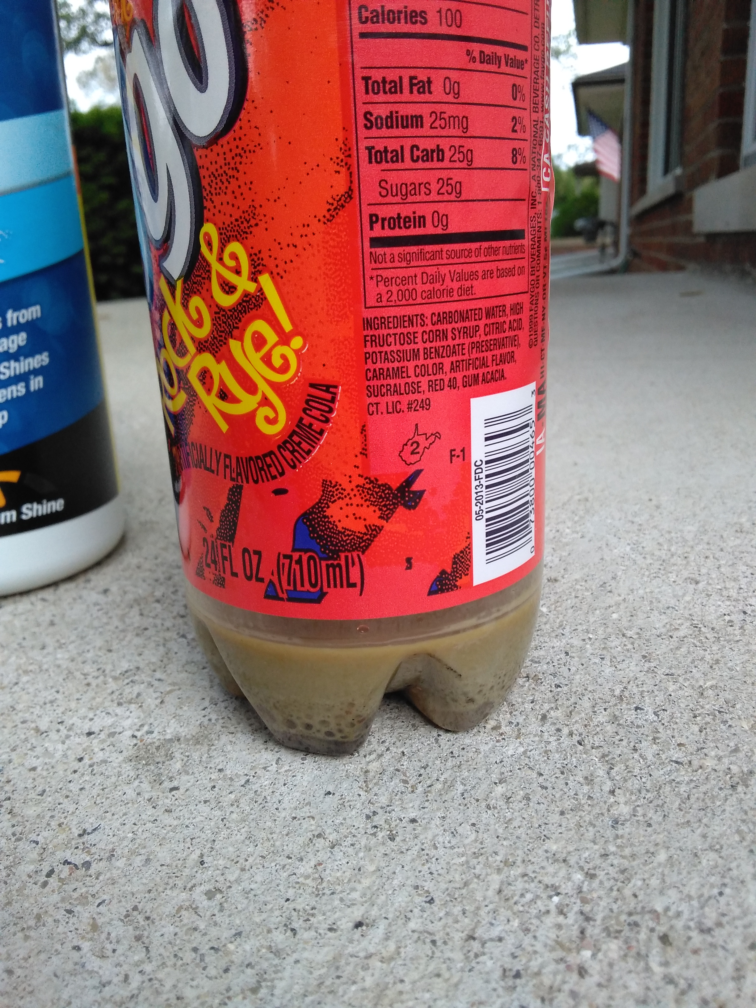

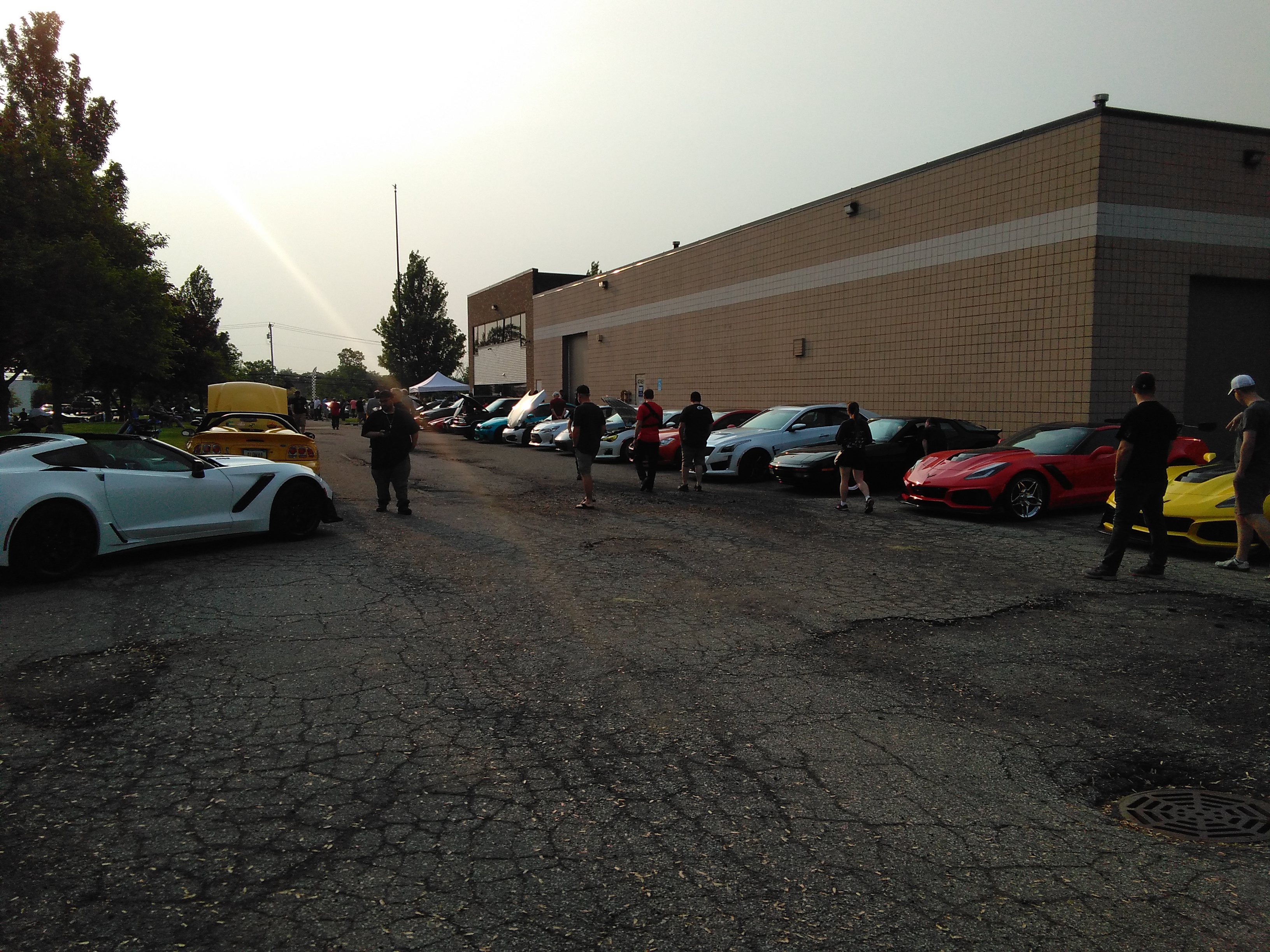

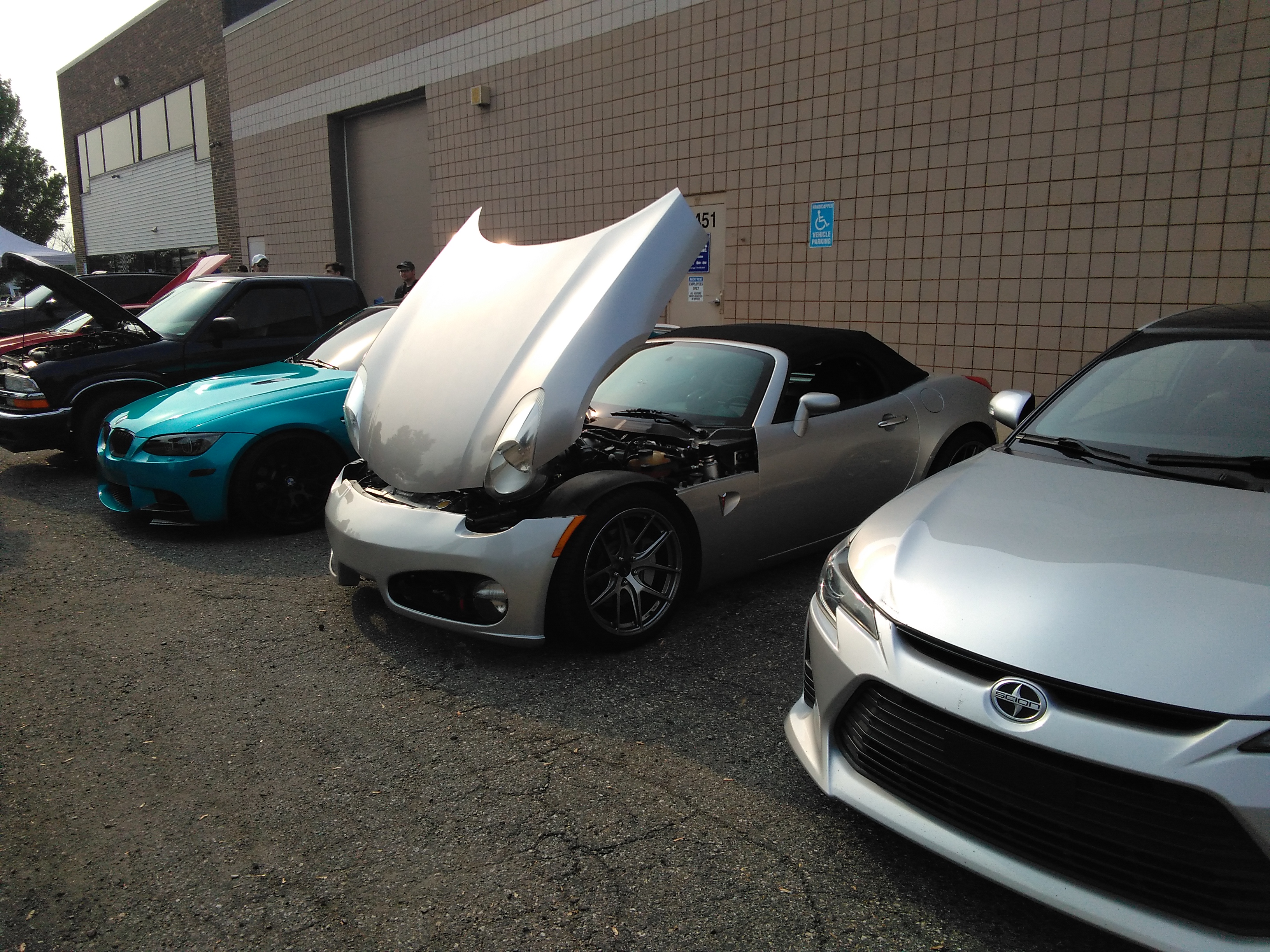

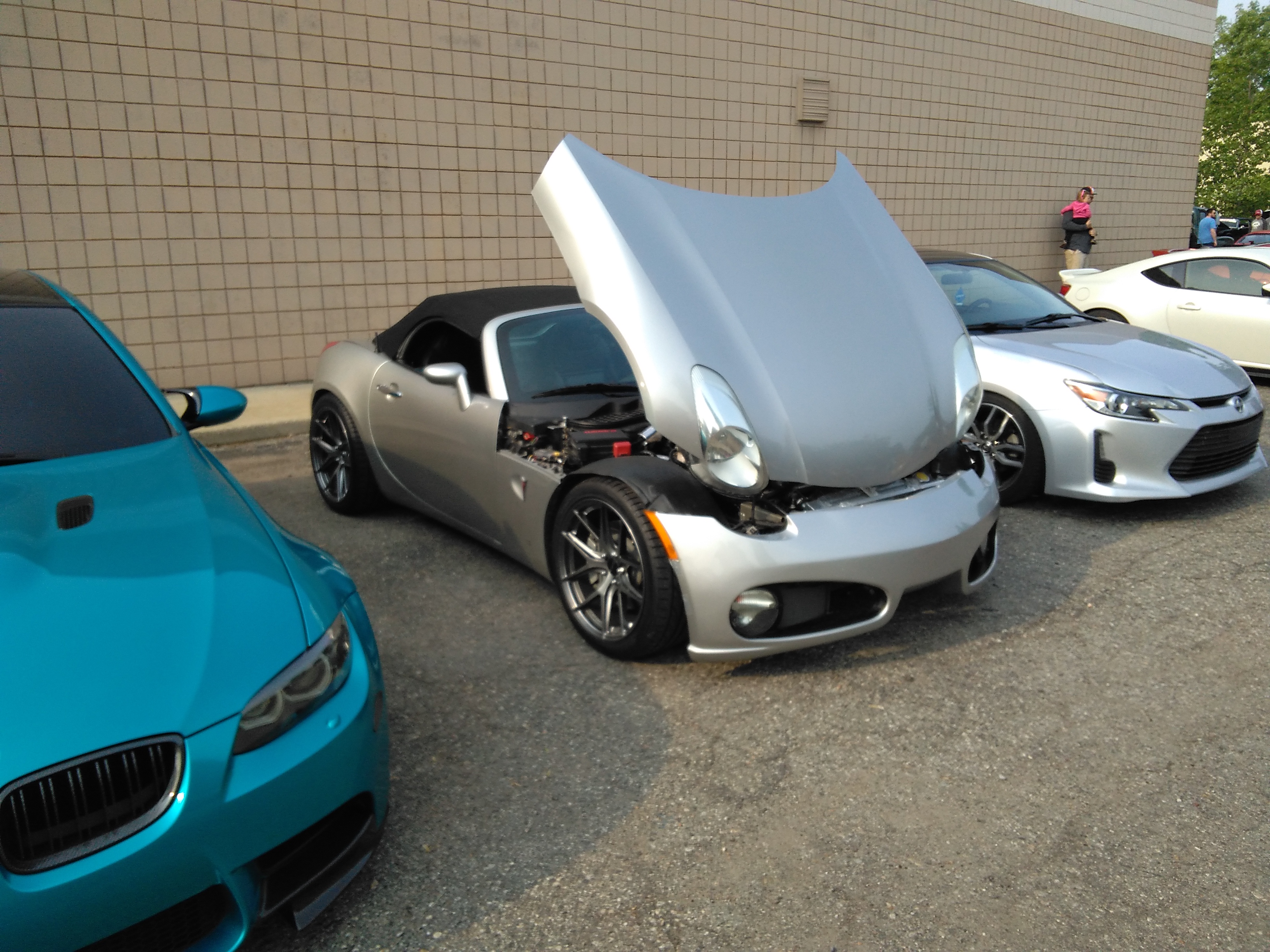

Lingenfelter Cars & Coffee (I rough counted 200+ cars)
150 miles blow-by, I was seeing 3x this with double baffle:
Re: Twincharged Solstice = Turbocharger + Supercharger
« Reply #311 on: June 04, 2019, 04:50:56 AM »
so the last pic is your oil?  or the drink itself
  • Posts: 764
« Reply #312 on: June 04, 2019, 07:17:33 AM »
That's the contents of the catch can. I was commenting on how it looks like it is improved wasn't sure if something changed here because of the SC.  If you go back to pages 5-6 you can see I built a catch can and pre-baffle and reading some of my posts there it now looks like this amount of accumulation I am getting right now is what is expected.
