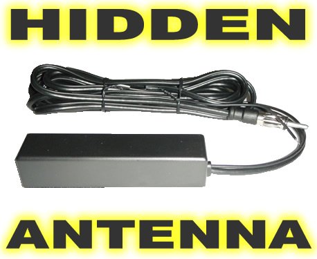

You could put this in a variety of locations: link
There are a variety of configurations. One of them could be in the top of the windshield above the mirror.
link
There are many more that could be made to work, and I am sure are smaller and better looking.
Jim :cool:

I wonder if the reception would be interfered with  if that was put in the interior plastic windshield surround that the sun visors snap into?
According to the directions it is fine behind plastic.
Jim :cool:
True.  Unfortunately however, that location would be behind the metal of the windshield surround, so would be shielded.

My '09 already has a box about that size & shape on the windshield above the mirror but it's not the antenna... not sure what it is.
On the coupe, the Onstar antenna is above the rear view mirror. If I was to put an antenna like that on the car it would be behind the waterfall beween the seats where no one would see it. I have my GPS antenna back there and it works flawlessly.
