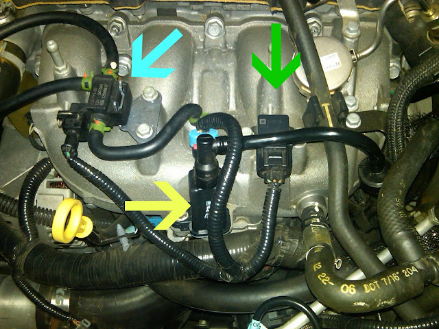

Take a minute and check the EVAP solenoid on the intake manifold. They are very prone to failure on the LNF engines and really easy to check. To check them all you have to do is pull the black plastic tube off of it by pushing the release. Then with the black plastic tube off, try to blow through the EVAP solenoid. You should not be able to blow ANY air through the solenoid. If you can blow even just a little air through the solenoid, it is bad and replace it.

I will check that out tonight although I feel like I am being setup for a YouTube Video.
Here we have elff blowing his engine
 :lol:  :rofl:
 Thanks for the advice.  I will let you know how that works out.
GJ was kind enough to create a picture so I know what to look at.

I could not blow any air through the solenoid.
