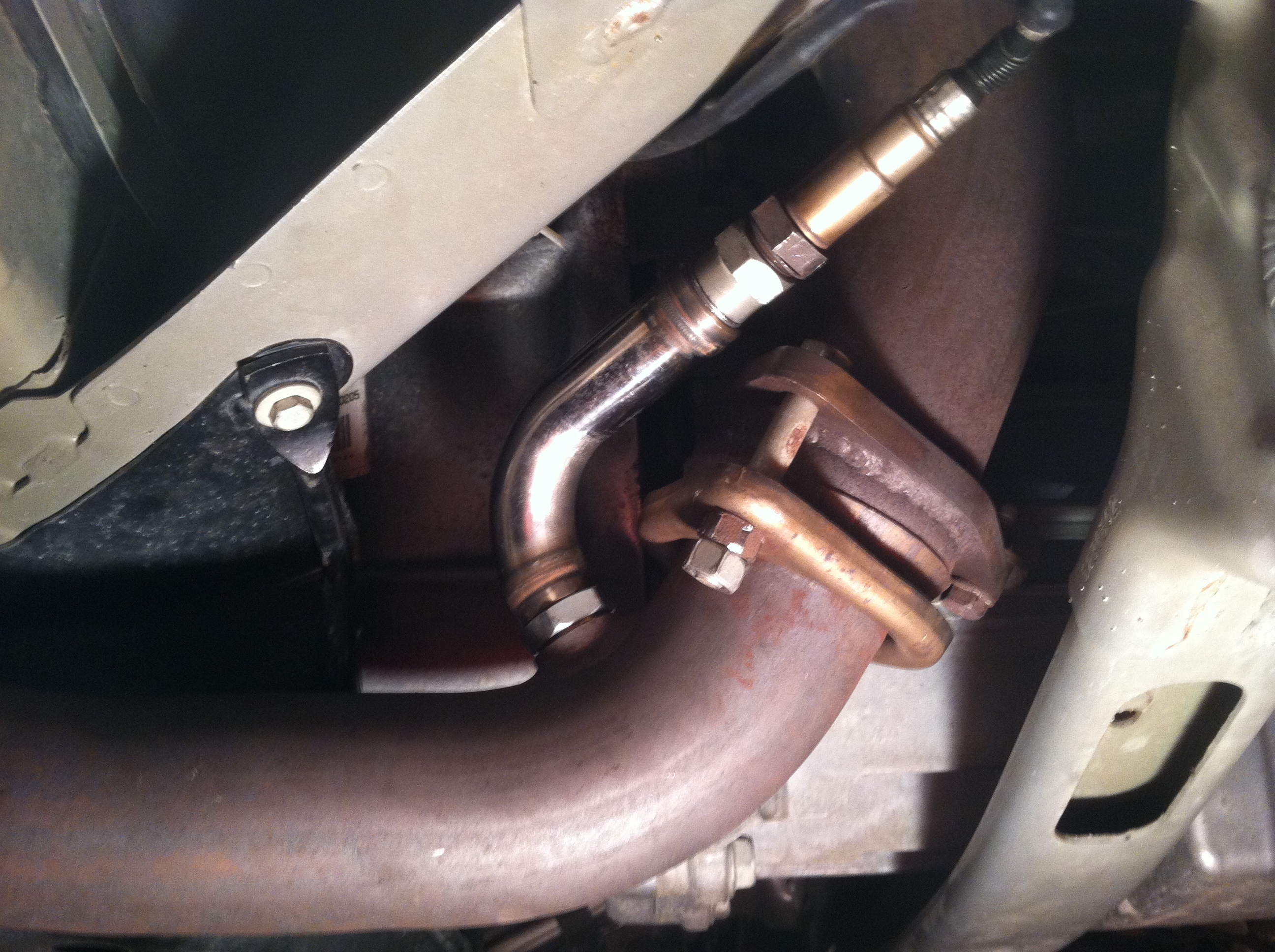

Well I have the CEL for the O2 sensor in the rear that from my understanding does not effect engine performance, but, hear some others say it does.  Anyone have an O2 extender that works in preventing the CEL to trigger?  I am thinking of buying one of these 2 products below to try and fix that.
http://vibrantperformance.com/catalog/product_info.php?cPath=1022_1069&products_id=1604
http://shop.zzperformance.com/store/p/1237-02-Bung-Extender.aspx
Thoughts? Input?

If you bought the Cat from Solo new, it should have included a steel extender.
If you did not receive one, give them a call
if you did not buy it new from solo
Give them a call and buy one from them so you know it will have the proper threads
did you have this problem?
edit:  I called them and they said with the catless ones they do not provide one because they say it won't fix the CEL

I used a spark plug spacer many years ago and it fixed it for me on my GXP

Even though I read the title, I was assuming you had their hi-flow cat vs a complete open downpipe.
I did not realize they sold different ones.
I have a Hi-Flow with the extender and no longer get the engine code.
I would think the extender would still fix the issue as it pulls the O2 sensor out of the direct flow.
If not, you have no recourse but to turn off P0420 in the tune or deal with the Cel.
If you can turn off P0420, then you can also retune your car since you need a licensed copy of HPT to do so.

Well I added the Vibrant O2 extender with one spark plug extender.  Hope this works over the next couple days.
Here is a picture of what I did for reference.  I think it looks pretty good  :D

« Reply #22 on: September 13, 2013, 09:47:20 AM »
That came out nice
let us know if it keeps the code away.

Tried the bung extender and it did not work initially.  Bought another bung extender from Vibrant and combined the two I had and the CEL still came on.  The code was bank 2 O2 sensor too lean.  I then took the one out and left the Vibrant one and we will see how that goes.  The car still feels underpowered to me and I still am not happy with the null performance gain I am getting.
After tomorrow I probably will take it off and put the stock one back on.
