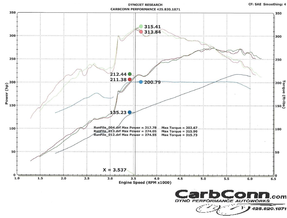

This was posted on another forum by the user Rosscoe, so with the high flow cat and exhaust and a tune they made 276 whp / 316 wtq which is about 324 bhp (15% drivetrain loss).  I hear 400 bhp is the max limit for the stock 2.0 engine a lot, so that is about 340 whp:

I have a Westers tune, high flow cat and Solo Performance Mach exhaust.  (become a supporting member here to get the discount to buy the tune)
The CAI doesn't help much and the upgraded intercooler pipes are a visual add only, don't wast the money there.
My rear wheel HP went from 219 (stock) to 286 (reverse calc to about 340 at engine).
