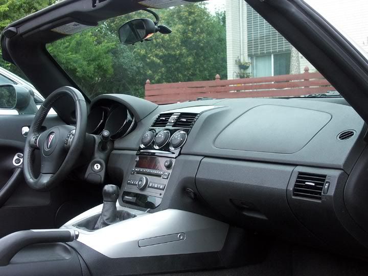

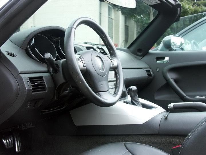

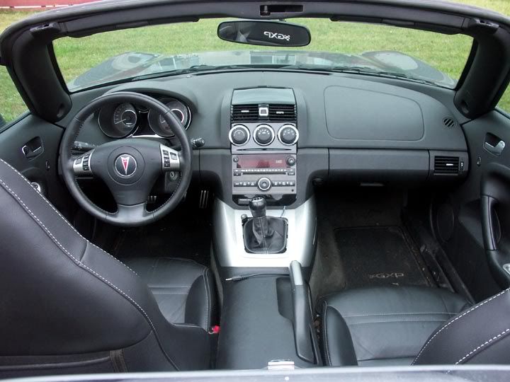

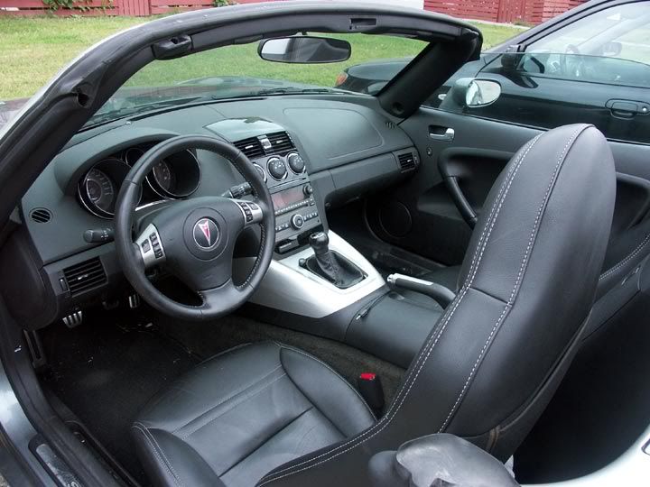

I have the full Sky dash in my Solstice GXP. Once I had all the parts it only took about two hours and some phone assistance from Joe at JPM.  Never regretted the switch, I like the Sky look much better and yes you do have to go as far forward as the bulk head, the Solstice door panels are fine. and the console back to the armrest needs to be switched to Sky.

I got the dash as a single complete piece from Shram's in Waterford, MI.  It seemed to be new and I believe it was an engineering piece.  Although it was not very expensive, i imagine buying the individual parts might be.  All switches, dash bracket, everything was included with the exception of the HVAC ducting, which is very different, and the metal bracket that provides the hard point mounting to the bulk head.  The plastic dash support was a close match to the Solstice and only needed minor modification to fit on the existing metal bracket, so that didn't need to be replaced.  It only took a couple of hours and a few tools plus a little phone help from Joe at JPM to remove the Solstice dash.  It's surprising how few screws there are.

Great job. Looks like a pro install
