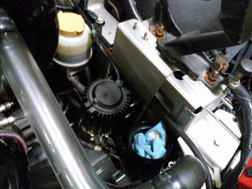

Caswell Ultra Wet Black Powdercoat
Turbowerx Exa-pump (ultra high performance electric scavenging pump for my turbo)
This is the only available spot inside the engine bay

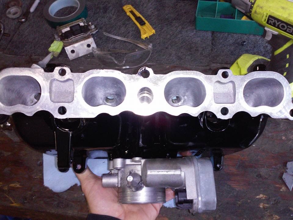

stock intake manifold w/ port injectors have been powdercoated and ready to be installed.
LE5 bigger throttle body was also fitted in this manifold.
manifold installed, but a longer charge pipe needs to be re-frabicated

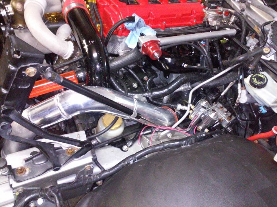

Fabrication of New cold side pipe that fits with stock intake manifold was finished today.

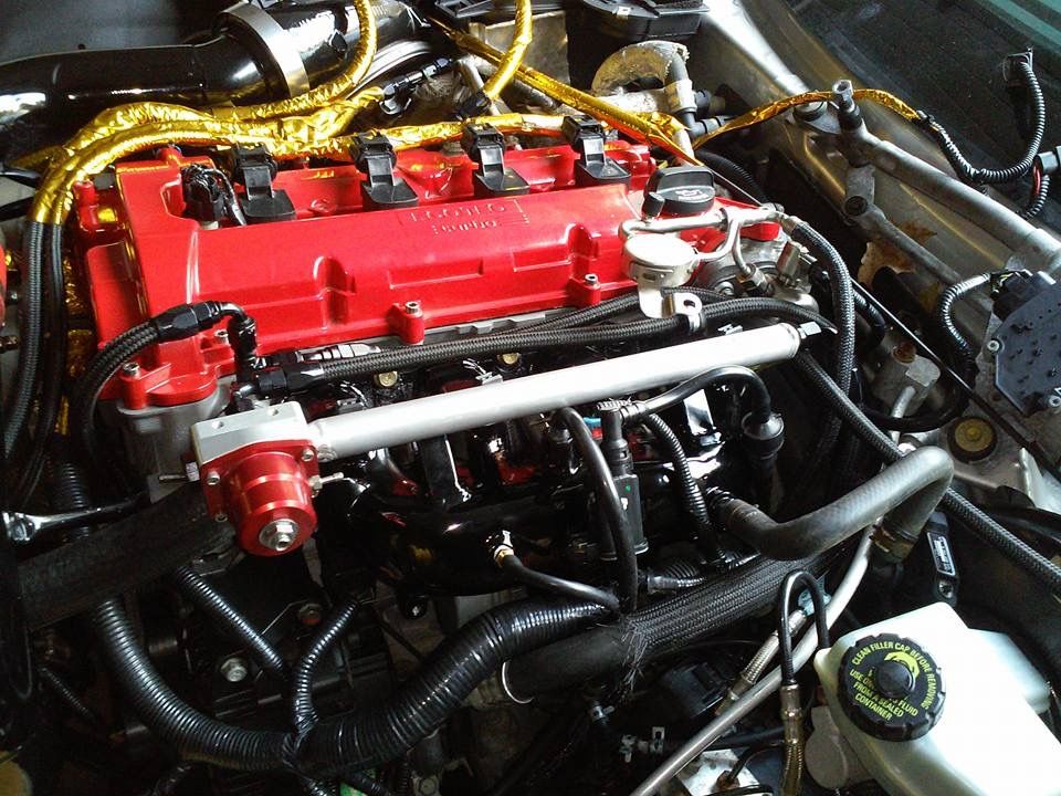

No engine leaks so far!!!   :)

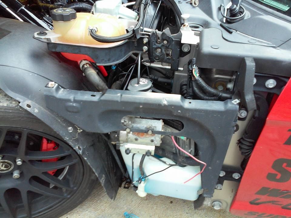

water/meth spray installed for inter-stage intercooling......which should help engine delta
all my controllers are nicely tucked in a safe environment:
