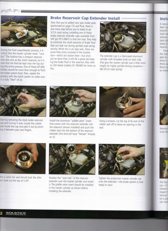

Strange. Not questioning what you are say. But, here is the page copied from the Solstice Performance book. Maybe Bob sort of "mis-spoke".
Since the complaint is the spillage, I don't understand where a bigger reservoir with the stock cap is the remedy. If the extended cap is actually the PCS0667 p/n, that piece is a low production billet aluminum piece so the price is probably in line. Maybe it is made from unobtainium.

The TSB, which I can't seemed to find, specifies upgrading both the cap and the reservoir, and that is what the dealer said as well, I sent Bob the part number #93172093 and his reply is posted above as to what choices he has available, larger volume of fluid will dissipate heat better and the one for the Opal comes with the cap. I would imagine if you got the aluminum reservoir you would want the replacement cap to go with it, I guess the aluminum acts as a heat sink or something. He said the Opal unit is much larger, it's only $57 and comes with a different cap, hopefully better. From the TSB, I did not get the impression the billet cap was any taller, just that it sealed better. I am sending him a check tonight, we'll see what I get soon enough. I just bought the blue goo and haven't changed it yet, perfect timing.
Maybe our Opal buddies can take a picture of there master cylinder and we can see the difference, there must be some reason they put it on the Opal?

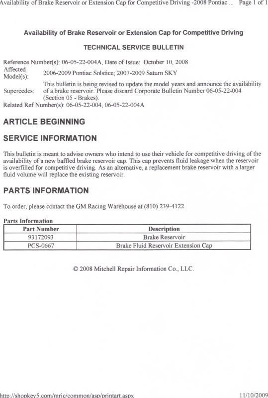

Thanks Bob but many of us can not see pictures from photobucket at work, I rarely login from home so I never see the pictures. Maybe Joe or someone can post these as an attachment.
Well, talk about a bit of a challenge. I have a Dell V305 printer/scanner/copier and the instructions are not the best. After f'n around with it, I finally figured out how to copy/paste the text from TSB. Didn't think about server security issues blocking pics. For those so effected, they may want to take a look at home for a previous post where I posted a scan of the Solstice Performance page about the cap. So, here is the TSB;
Availability of Brake Reservoir or Extension Cap for Competitive Driving
TECHNICAL SERVICE BULLETIN
Reference Numbers): 06-05-22-004A, Date of Issue: October 10, 2008
2006-2009 Pontiac Solstice; 2007-2009 Saturn SKY Model(s):
This bulletin is being revised to update the model years and announce the availability Supercedes:     of a brake reservoir. Please discard Corporate Bulletin Number 06-05-22-004
(Section 05 - Brakes). Related Ref Numbers): 06-05-22-004, 06-05-22-004A
ARTICLE BEGINNING SERVICE INFORMATION
This bulletin is meant to advise owners who intend to use their vehicle for competitive driving of the availability of a new baffled brake reservoir cap. This cap prevents fluid leakage when the reservoir is overfilled for competitive driving. As an alternative, a replacement brake reservoir with a larger fluid volume will replace the existing reservoir.
PARTS INFORMATION
To order, please contact the GM Racing Warehouse at (810) 239-4122. Parts Information
Part Number   Description
93172093   Brake Reservoir
PCS-0667   Brake Fluid Reservoir Extension Cap
