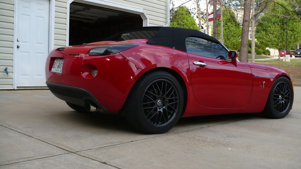

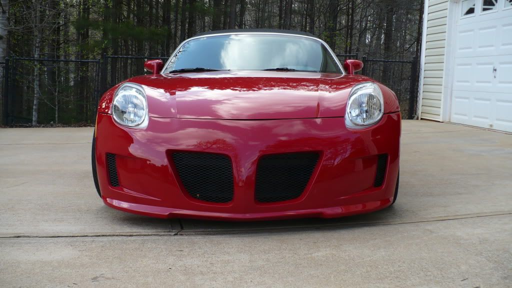

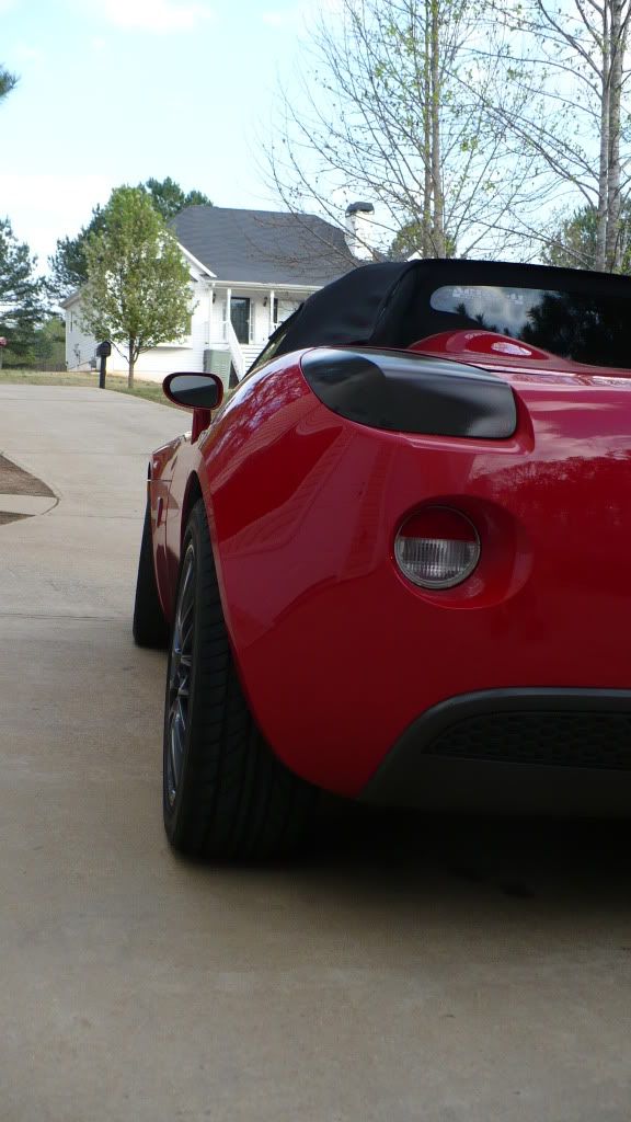

Its a 2007 solstice na with a few mods to it.
The front bumper was just put on and im waiting on sideskirts for it which are being painted.

Looks good, I especially like the wheels, what kind are the?

those are the enkei ekm3 wheels.

What else have you done, other than the nose, sideskirts, tinted lights?

i have a true cold air down by the fender and a borla exhaust with no cat. other than that it's stock
