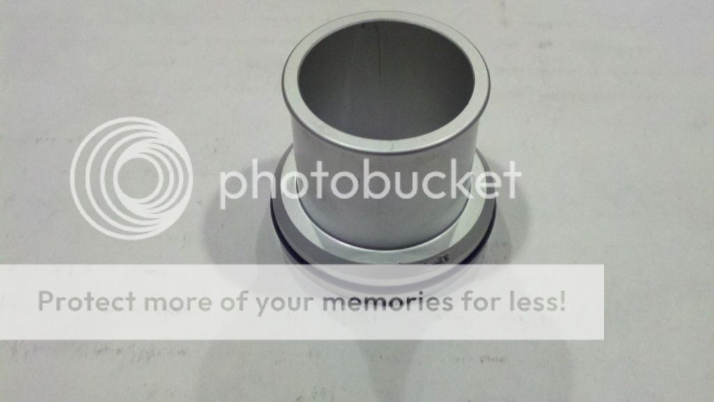

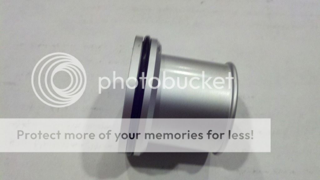

  • Posts: 11395
Re: BNR 2871 Flutter
« Reply #22 on: September 26, 2012, 11:08:29 AM »
You can not run the anti stall and the recirc fitting at the same time, and you would not need to.
The anti stall is used if you want to avoid recirculating the blow off on a MAF
Problem is, the antistall does not work with our cars.  You get the same code you are currently receiving.
With a good tune, it's really not an issue.  I am just being a perfectionist.   My setup runs fine.
  • Posts: 1994
« Reply #23 on: September 26, 2012, 02:01:06 PM »
+1  GASNGO, are you running the anti-stall on the BOV?
Miller, are you selling the complete Synapse, or just pieces of it?  It might be worth trying it out if it can be plumbed up in the silicone I already have.
I just have the pcs parts. I sold the BOV with my turbo kit. As far as the anti-stall valve, I really like the sound it made, and it worked fine on an untuned stock turbo car. I only ran into issues when I upgraded to the 2871. The anti-stall gives you a slight "fluttering" sound w.o actual flutter.
I basically have everything BUT the BOV itself. Shoot me a PM, I am willing to sell any pcs that you need.
