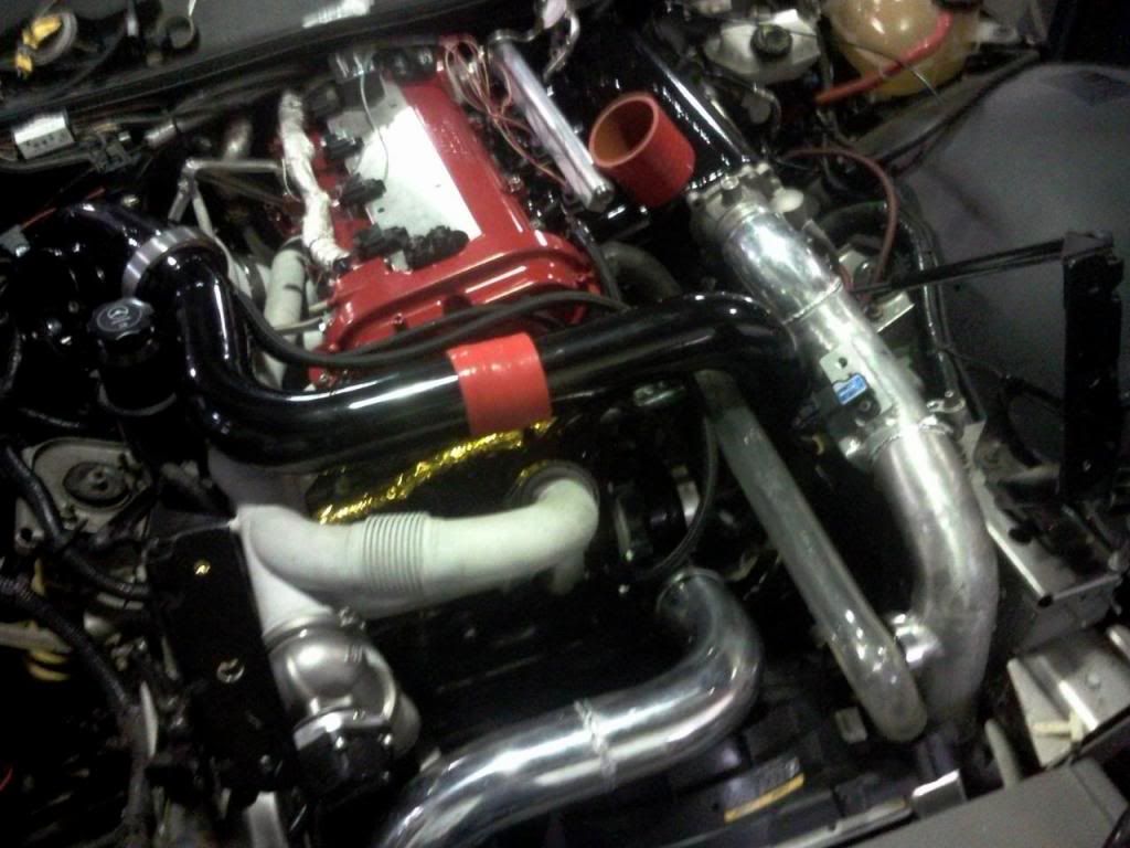

Well only another 47 heatshields to fab and a gajillion miles of wiring to sort.   Due to the tons of hot tubing inside the engine bay, melting of important wiring is the biggest concern.
The oil drains are now .085" wall aluminum tubing, the power steering system and reservoir was relocated and reservoir swapped out for a WRX reservoir.
The water neck on the top of the radiator was changed because it was rubbing and the glass coolant tube and charge pipe weren't parallel to each other.
Mounted the secondary fuel pressure regulator directly to the rail instead of on the frame (that's a no-no as per racing rules).  Now working on a bracket for the fuel pressure damper that has been free hanging on the DI pump thus far.
Brackets are getting welded to the top of the intercooler core  since it  precluded the use of the crash beam, there is nothing holding the top of the front bumper cover and it flops around
The pass thru for the engine harness between the primary header and the low pressure turbine feed is the trick here, it's fabbed from aluminum chargepipe tubing with a flare mouth aimed at the radiator fan to not only heatshield, but aircool the insulated harness
Re: LIPSTICK'S 800hp first LNF compound turbo/engine build!
« Reply #424 on: October 21, 2013, 01:59:45 PM »

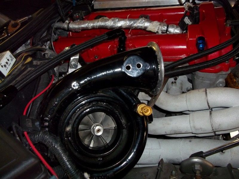

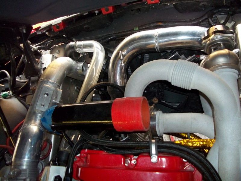

some photos (SORRY FOR THE VERY DIRTY IMAGES!)
Aeromotive fuel pressure regulator for the secondary fuel rail.   Werks Intake manifold below with port injectors.
the Purdy GT4294r
Boost brace for support
DEI gold heat shield to cover the important wires and hoses
