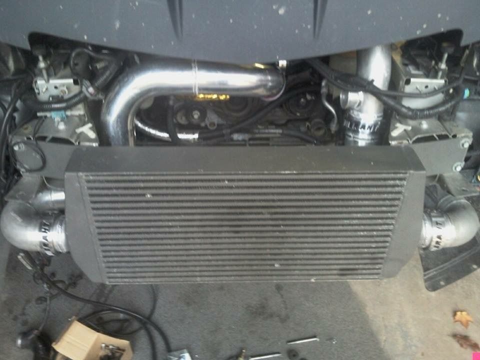

Wouldn't t-bolt clamps be more robust?
Re: LIPSTICK'S 800hp first LNF compound turbo/engine build!
« Reply #618 on: March 13, 2016, 07:16:04 AM »
No bob, using t-bolt clamps usually means using a silicone to attach a charge pipe to an intercooler's end. Sometimes this t-bolt will slip, or the silicone rips.
I'm using Vibrant vanjen clamps that locks up two aluminum assemblies together.
It has o-rings to keep it fully sealed as well.
But I wish I used Wiggins brand, which is the best of the best, it's about $300 a set those.
I needed 3 sets for my application tho.
Anywho, you can see here where I used the vanjen clamps
