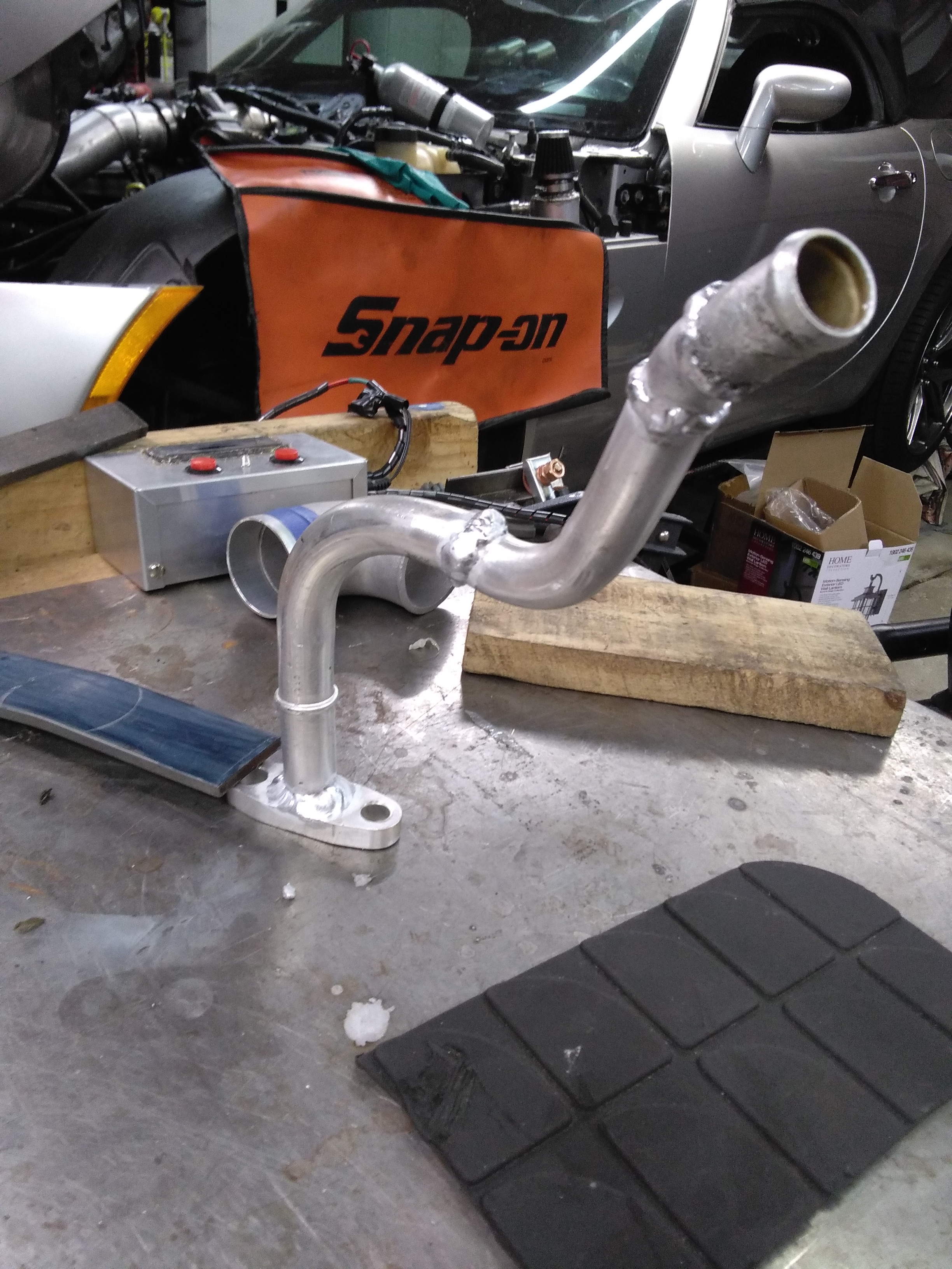

Turbo oil drain...
Amateur welder + 23 year old dirty heater core tubing =  :idk: functional

OMG were you trying to redefine Booger Welds?
  • Posts: 773
Re: Twincharged Solstice = Turbocharger + Supercharger
« Reply #353 on: August 03, 2019, 02:31:16 PM »
It literally holds water though  :D  With tig you can at least make sure each blob is a good blob
This was a bit easier, thicker cleaner material:

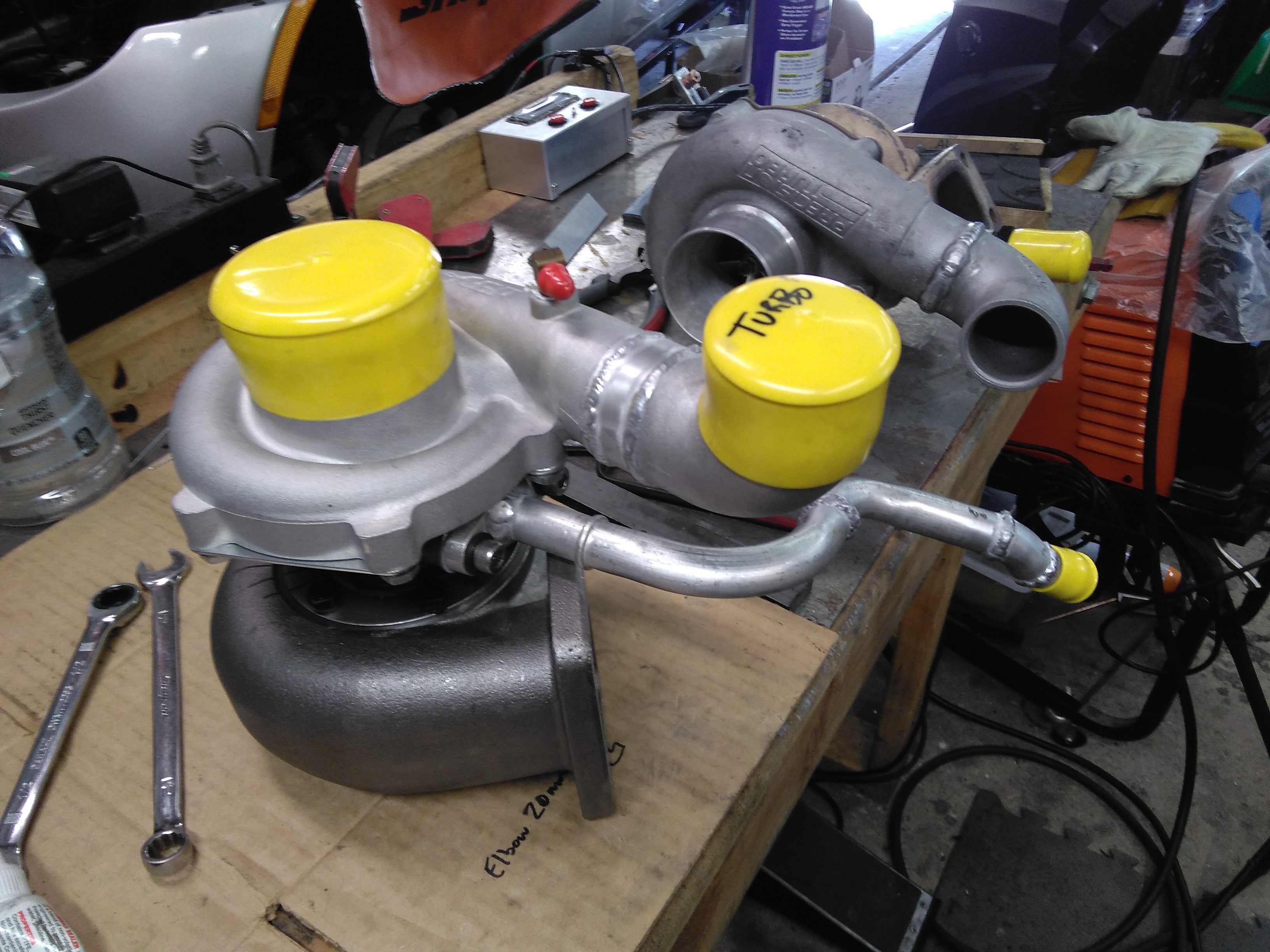

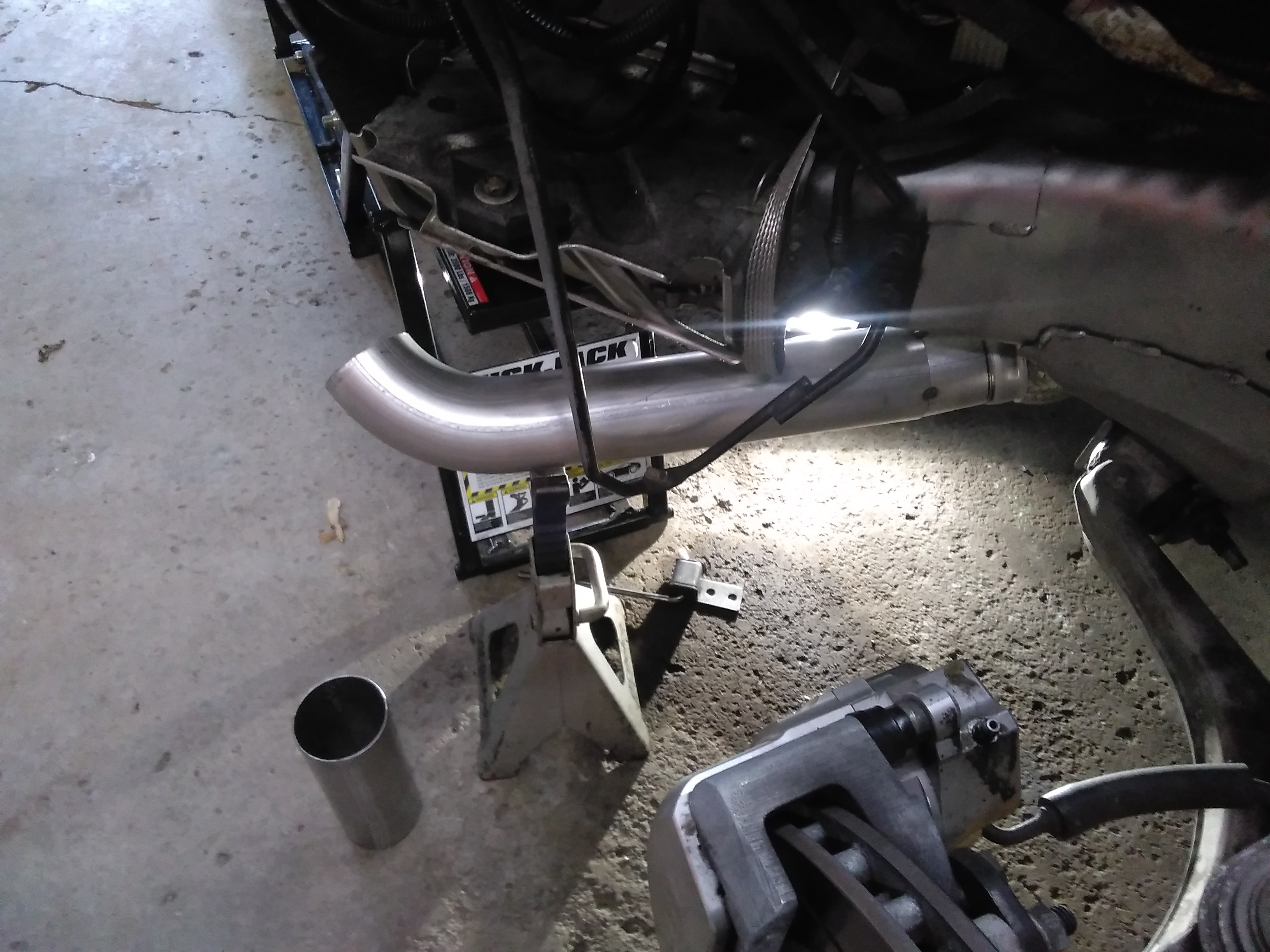

Oil drain installed, the turbo can be installed like this too:

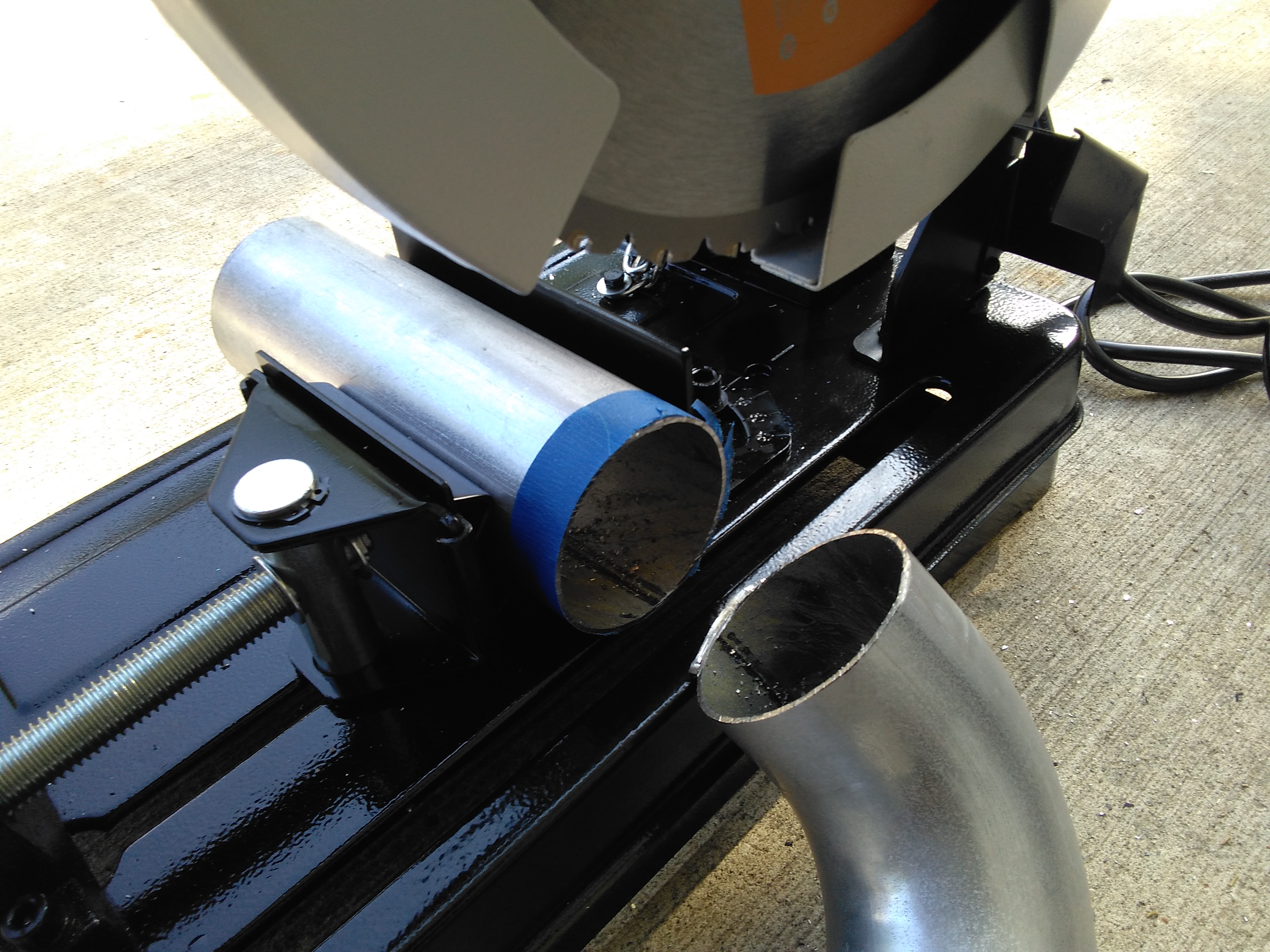

The old abrasive chop saw I have was one of the first power tools I bought (about 13 years ago harbor freight) and with the exhaust work ahead of me it was the perfect excuse to get a new geared carbide metal saw and it is awesome.  I dream of getting a real cold saw, but this is about 1/12 the cost and stowable in my tiny garage.
Rage 2 saw: https://www.homedepot.com/p/Evolution-Power-Tools-14-in-Multi-Purpose-Chop-Saw-RAGE2/203633549

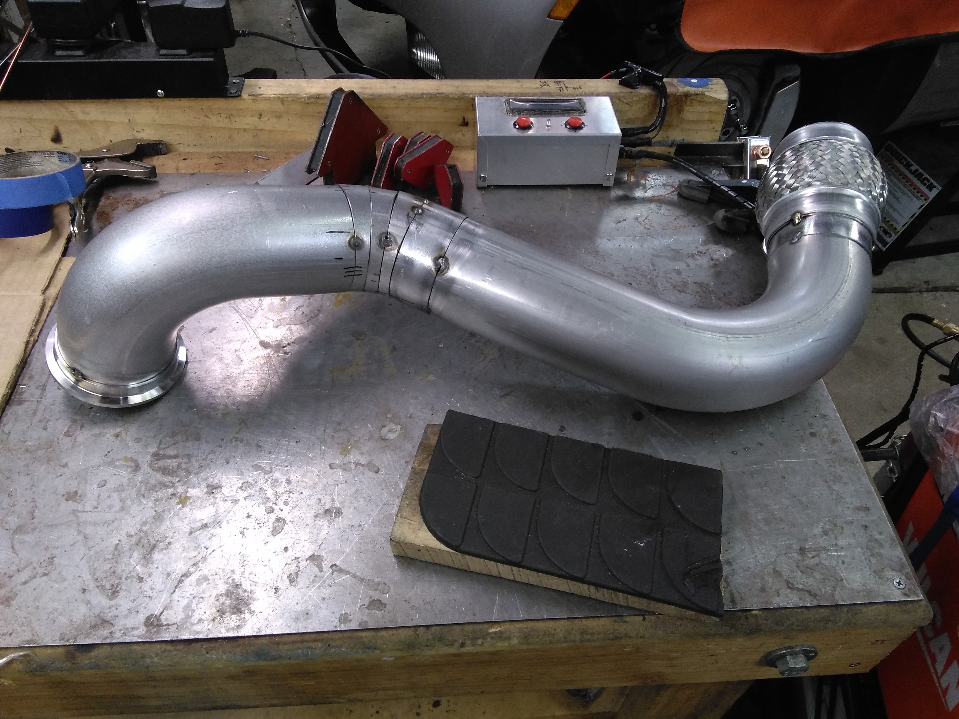

Tacking away, build to fit:
Who's triggered by the side dump?  :goat:

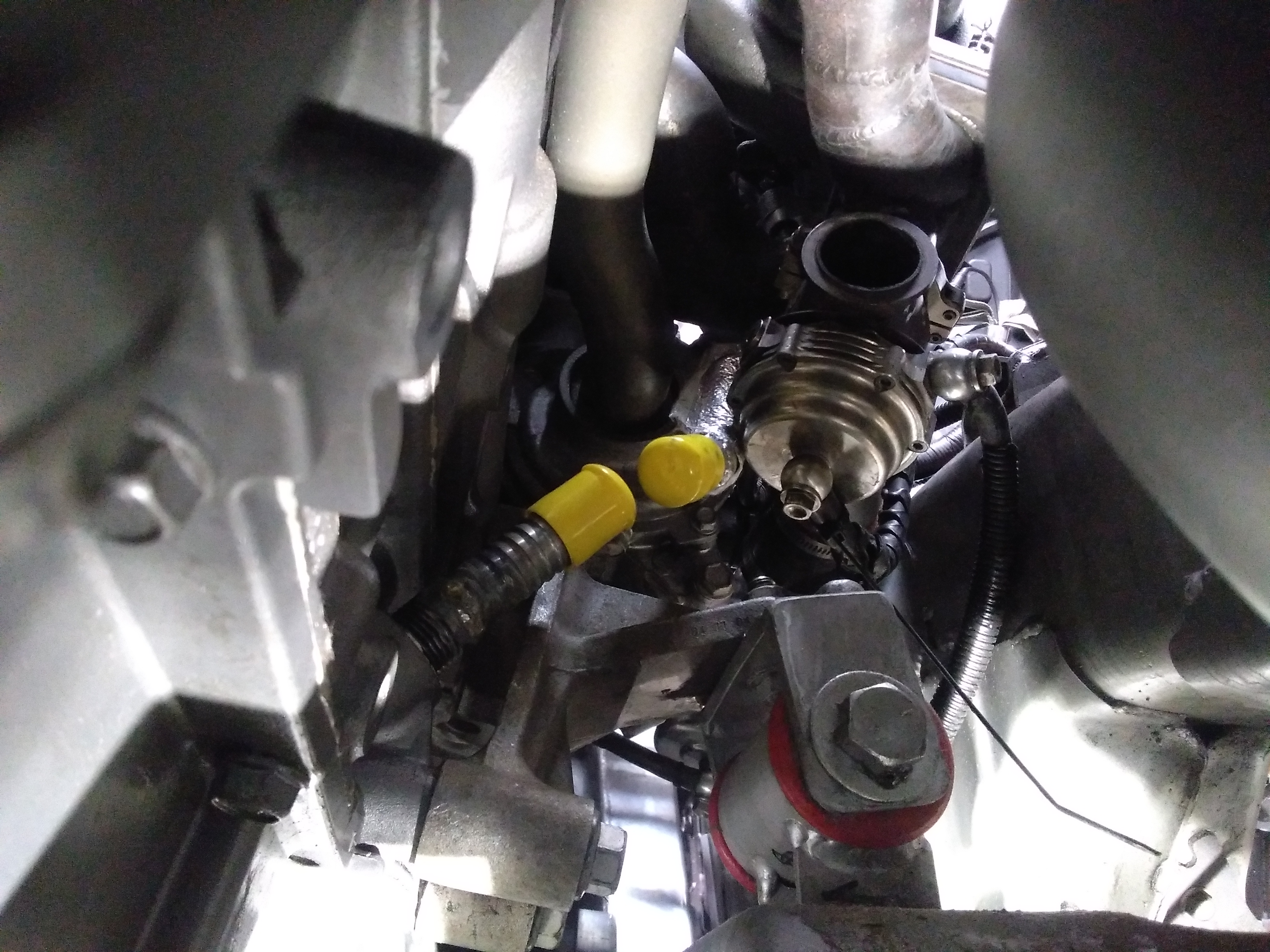

Custom nipple in the oil pan (bedplate) to meet up with the booger tube. The yellow things are plugs, I'll slip 3/4" hose in there:

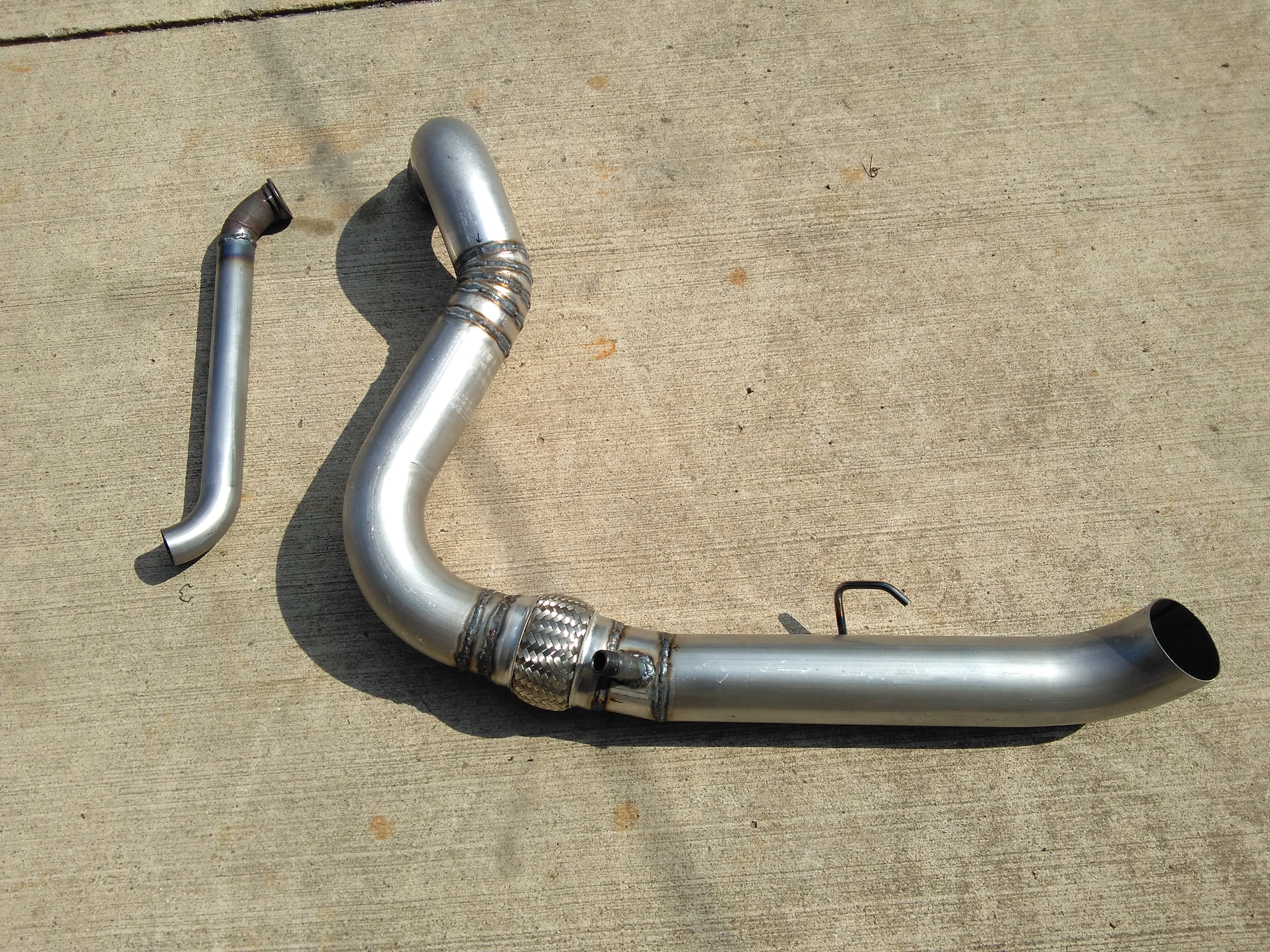

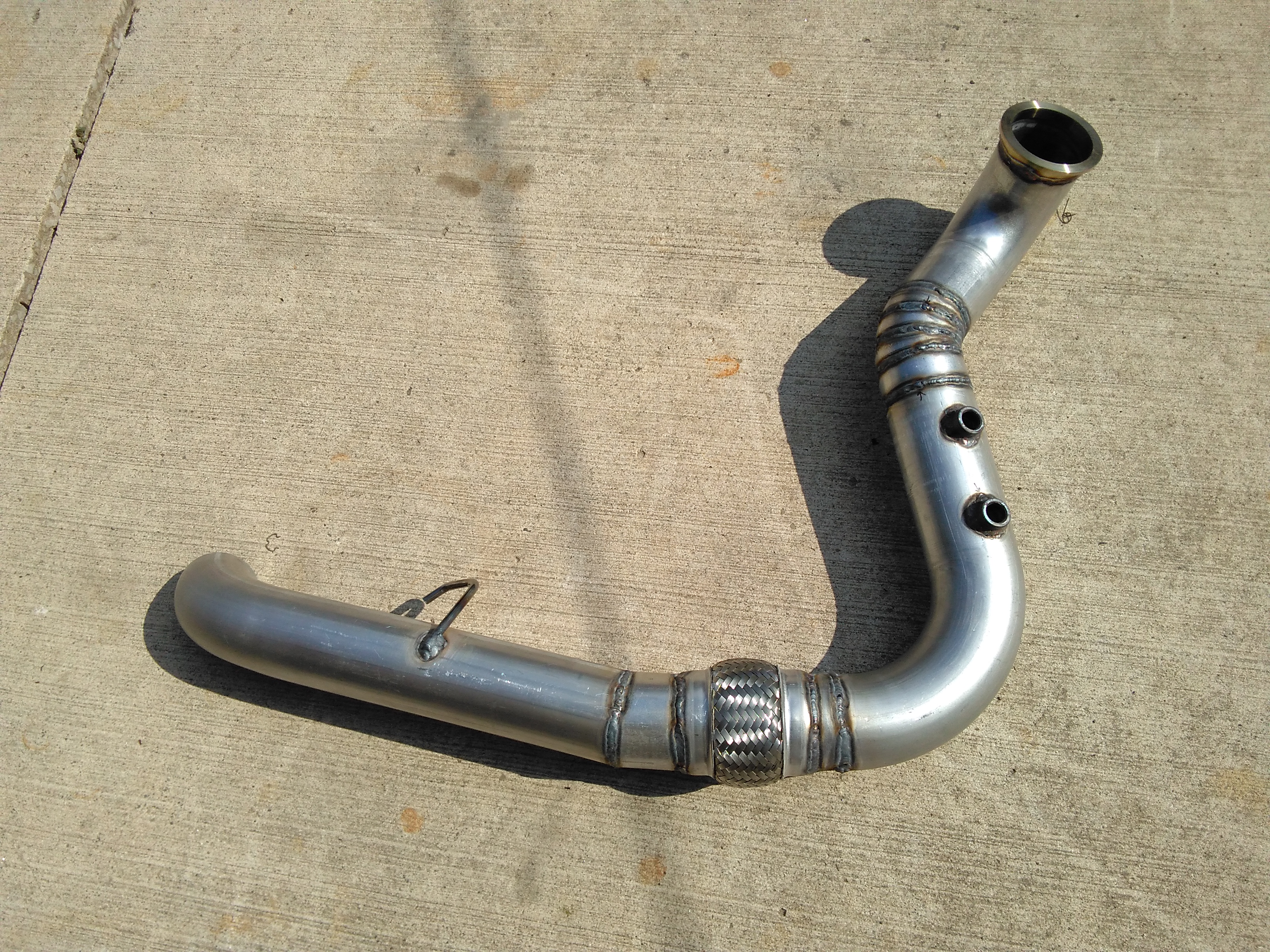

Off-road race turbo downpipe done. The wastegate is a screamer for now, need to get a flange and integrate it into the main pipe.  Notice the PCV vacuum "eductor jet pump", this will create a vacuum with exhaust flow energy.
Moroso PCV check valve: https://www.moroso.com/catalog/product/view/id/7215/s/check-valve-for-header-collector97800/
Moroso vacuum nipple (I made my own with a cutoff wheel): https://www.moroso.com/catalog/product/view/id/7216/s/weld-in-nipple-for-header-collector97810/
Otherside with the O2 bungs:
That was a lot of tig welding this weekend...

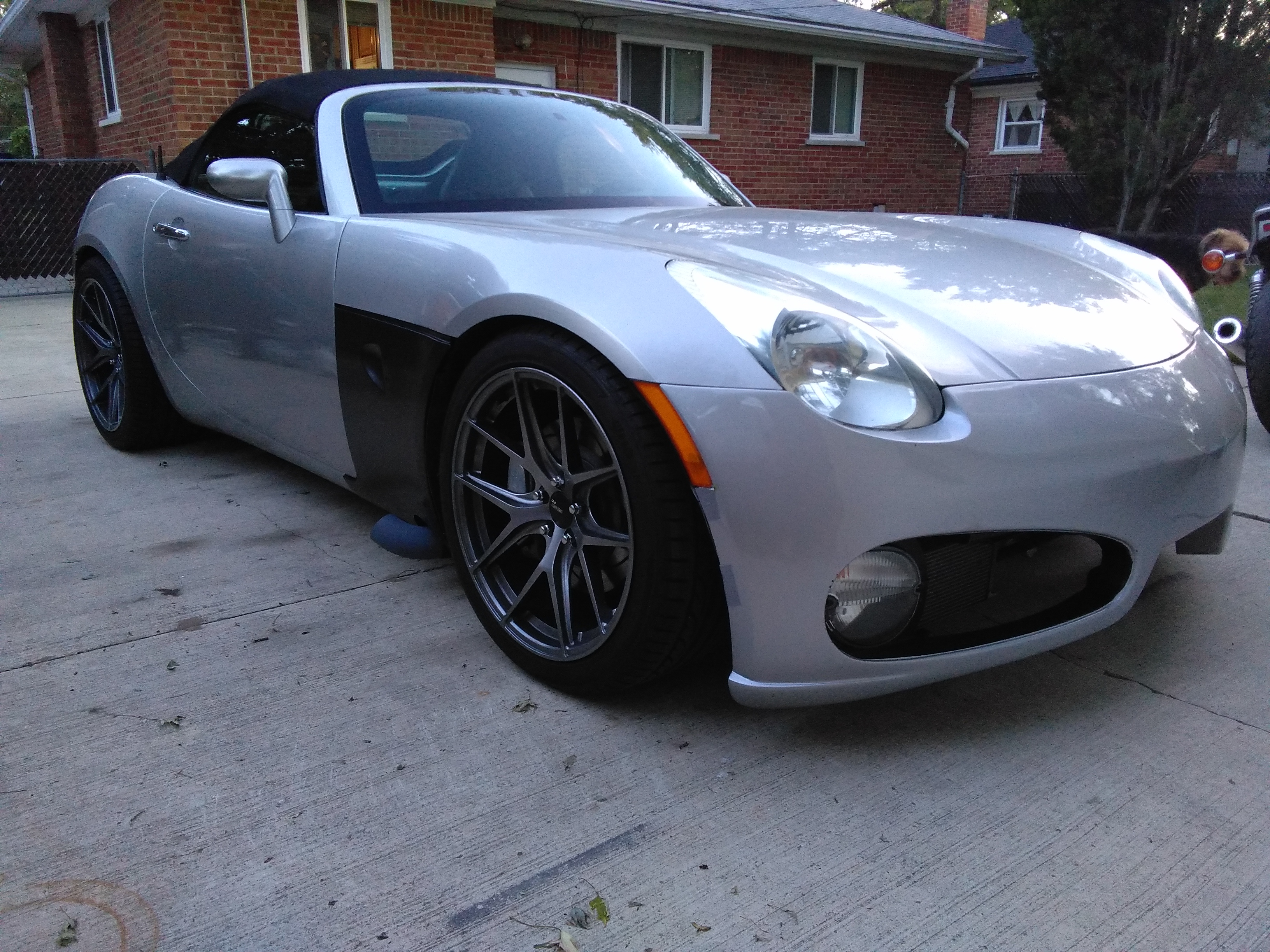

What?

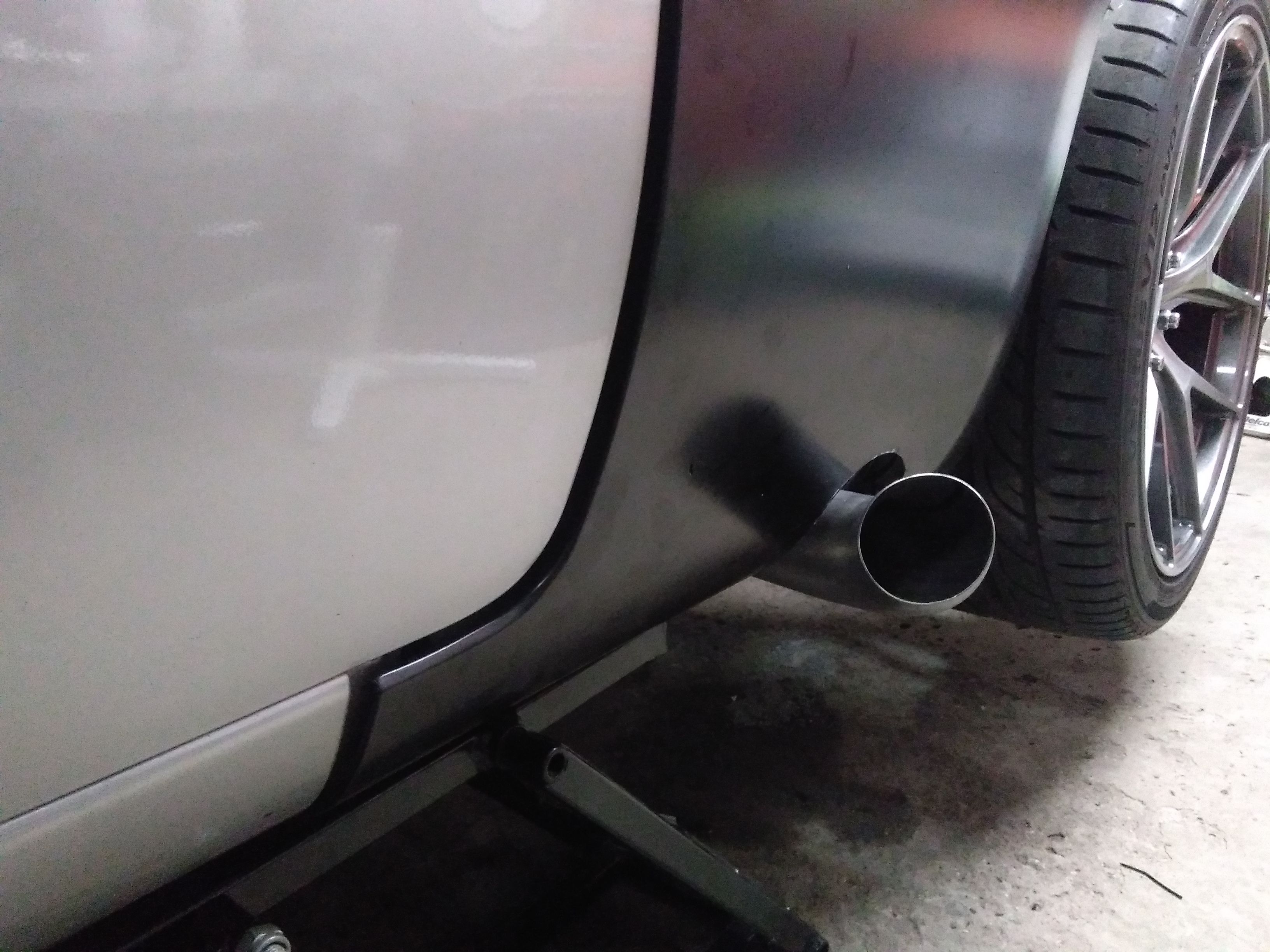

What is this under the fender crap?
You gotta go through the side fender to be super cool!
Are these not cool enough?

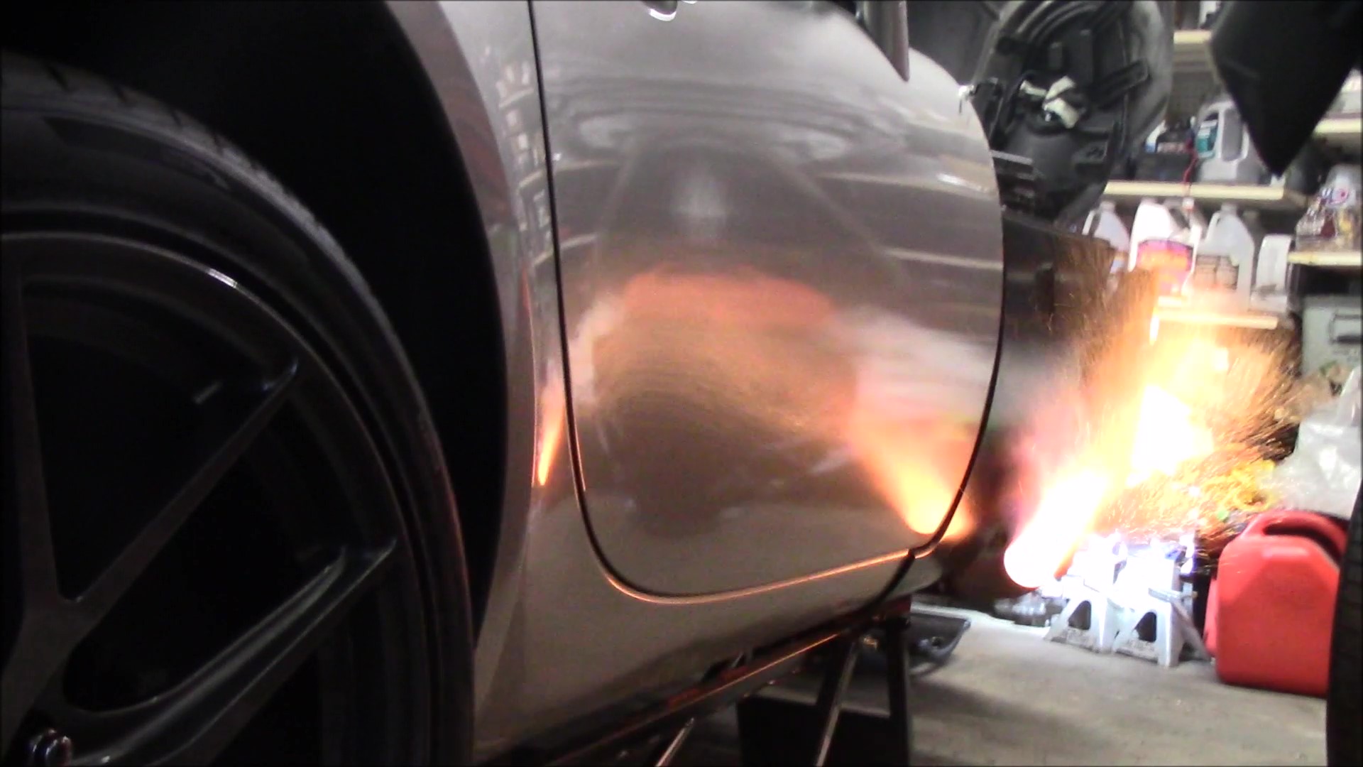

Cold rev explosions holy crap. This is on the old tune with the 2.5" single exhaust and smaller turbo.
The third clean rev actually went into PE mode (enrichment) where as the ones that explode have correlating lean spikes, but not sure which led to the other: https://www.youtube.com/watch?v=cc2I1gxD2Zc

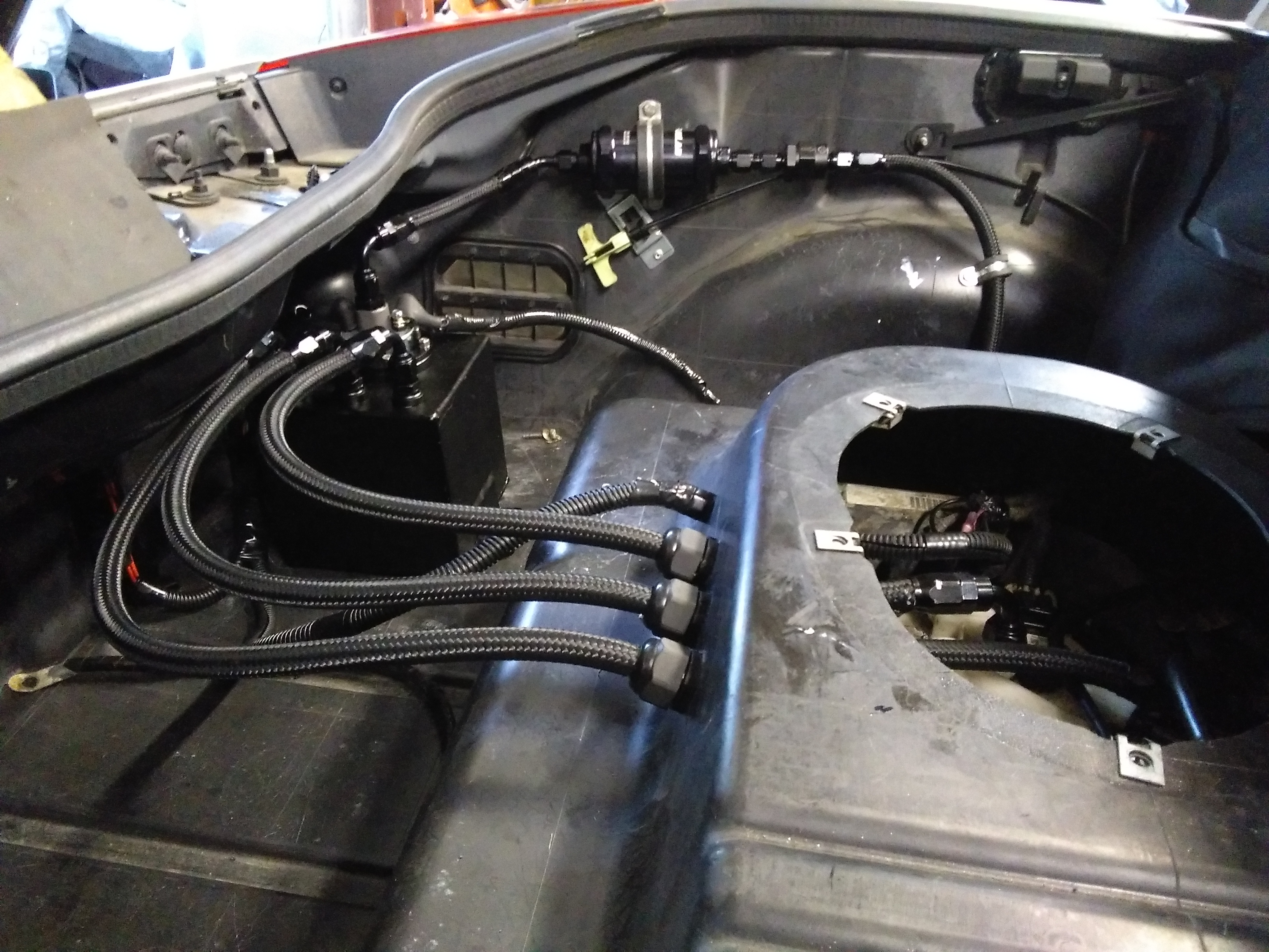

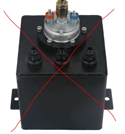

Warning: Do not buy $50 fuel surge tanks off ebay.  One day I back out of the driveway and my trunk filled with fuel.  I could not replicate the source of the fuel leak but it could only be from the surge tank; the only think suspect is the o-ring and tolerances that seal the tank.  I am running a Deatchwerks pump 044 pump so doubt that is the issue.
Surge tank of death:

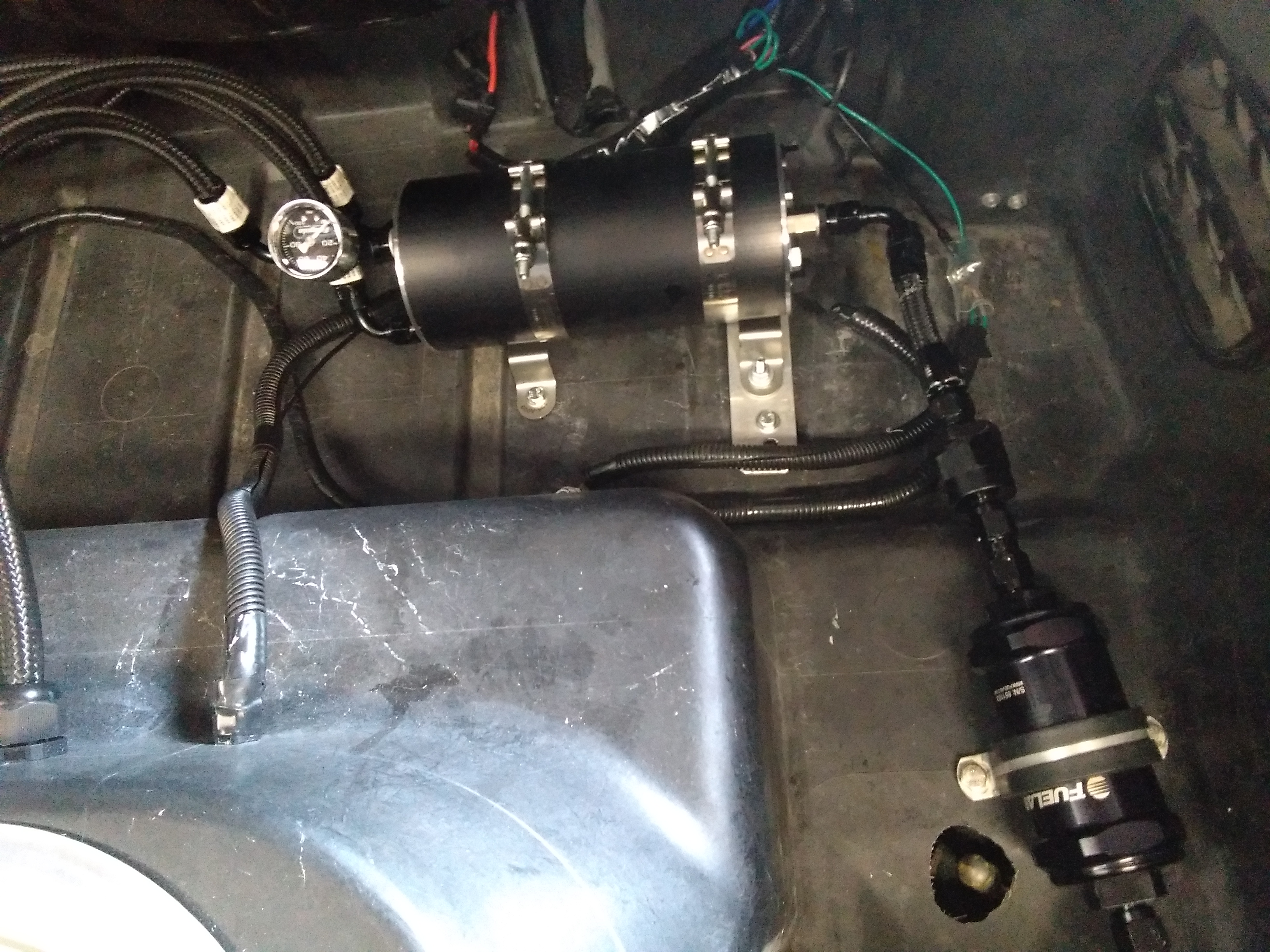

Well engineered merican surge tank:
https://store.034motorsport.com/fully-enclosed-fp34-fuel-pump-surge-tank-for-bosch-044-motorsport-fuel-pump.html

there are some china compound rubber that they make seals out of that dont like our gas. even china fuel hose.I put new china fuel hose on my 6 chain saws( huricane supplies) and...withen a hour the hoses were funking up the carbs or spliting,popping off. I suppose they are ok somewhere else in the world...so..as to your ebay tank...mine were ebay and directly from china hoses... the china aluminum an fittings leave a lot to be disired, but so do the amreican ones too....boy do i have a story about a pile of very expensive american an fittings that were junk..real engine/ fuel system killers...earls I think,hard to remember after buying oh somany of them, aeroquip was always the best. to make it short dont ever buy the aluminum " stainless look" fittings.I think there off the market now.they were aimed at exzotic fuels..and fools...apparently.   the "stainless" coating came off in oh so needle size  extra hard sharp slivers, lot of them...on the inside of the fitting..to go into your engine..and fingers too.
No.  They look like those cheap pep boy bolt on exhaust tips.
I'm just messing with ya, cause someone actually put the exhaust through the fenders.  I don't see how that wouldn't melt them eventually.
  • Posts: 773
« Reply #364 on: August 11, 2019, 08:35:57 PM »
It is obnoxiously loud, however with a v-band system off the turbine I'll make a full exhaust for the street and quick swap this side exit for race days.

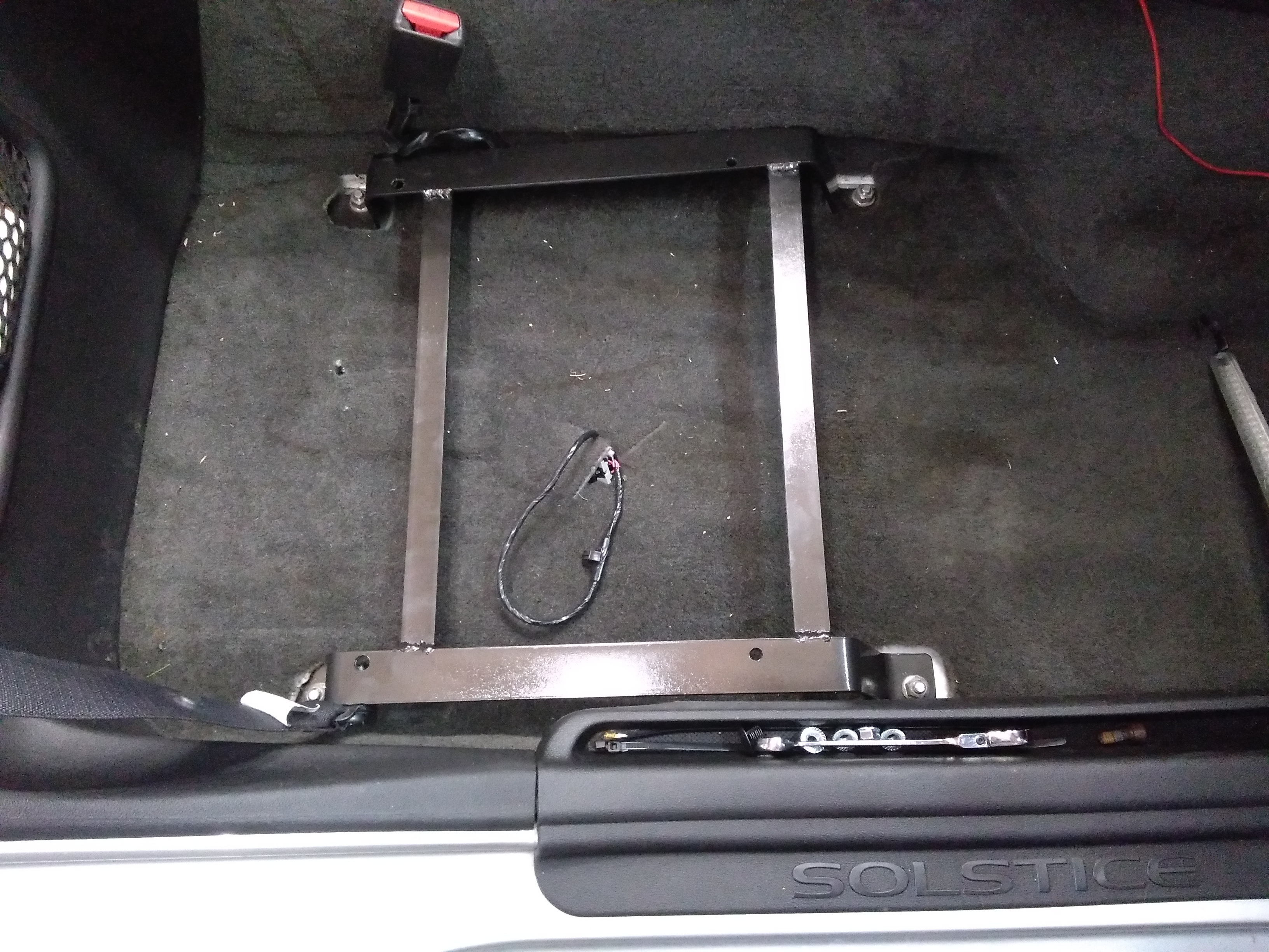

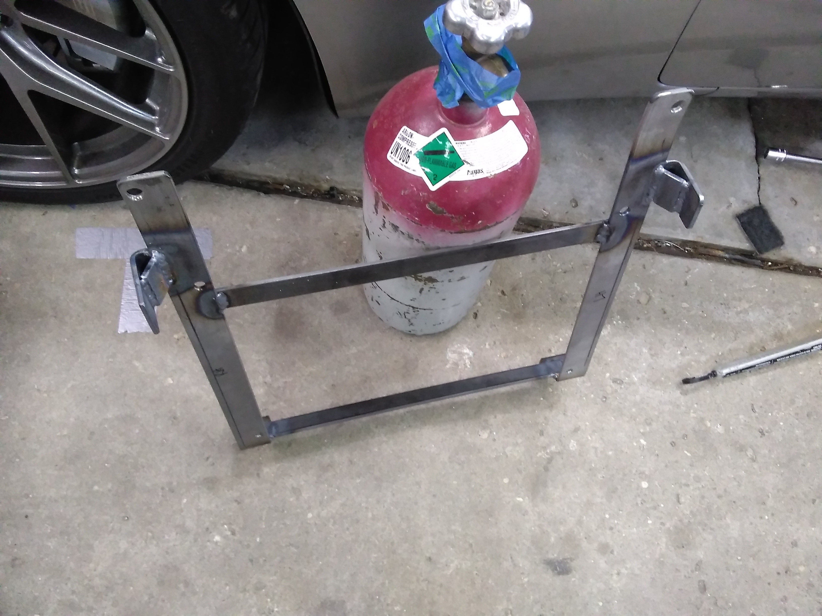

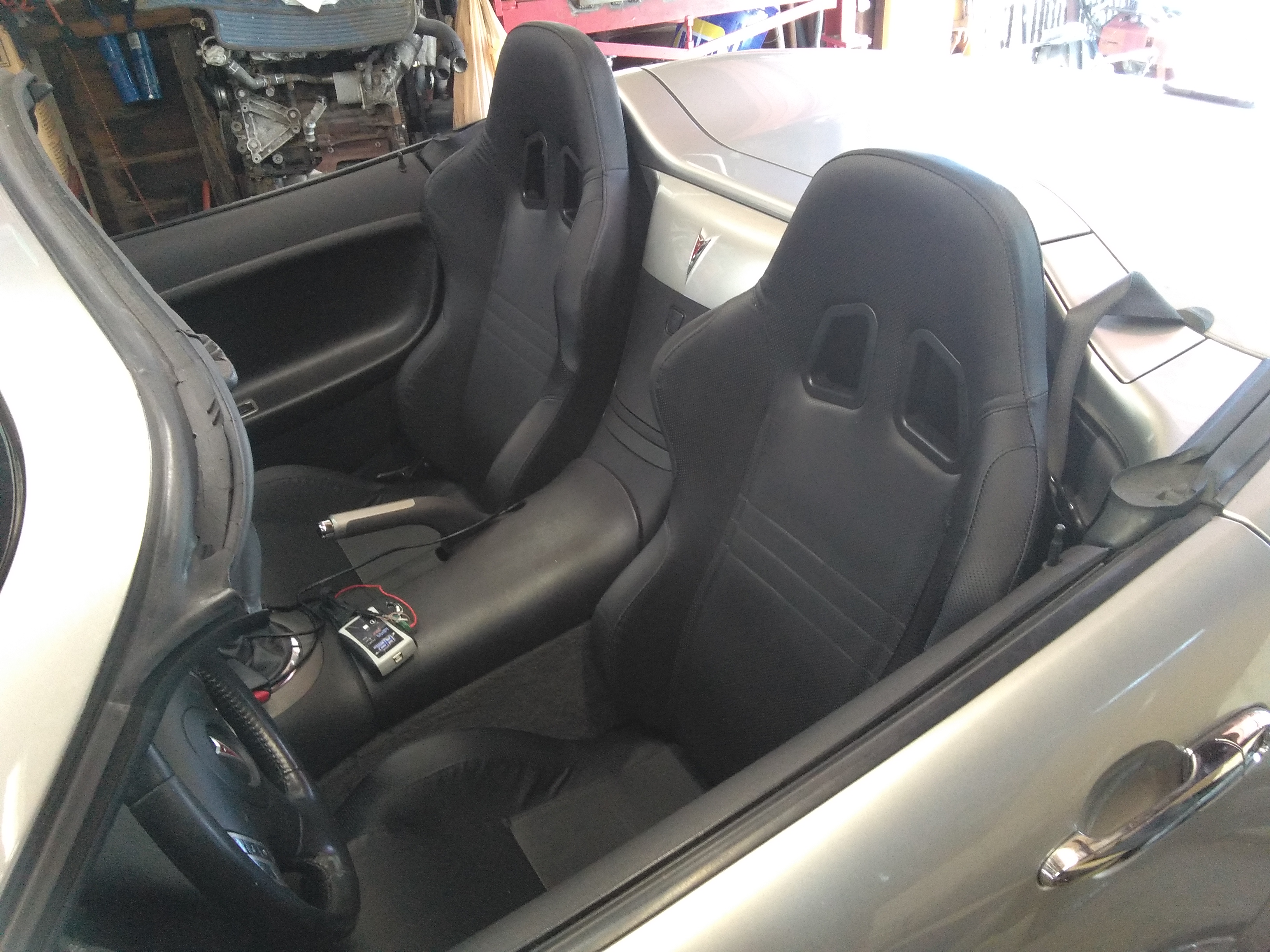

The stock seat bolsters on the driver side were blown out (large previous owner?), autocross would suck without some support  For the seat mounts I used 3/16" steel and also had to also fabricate the seat belt mounting points.  They sell the seat mounts but they are super expensive.  The passenger side sits a little bit higher because the seat bracket must bolt in before the seat is bolted to the bracket (if you want the passenger seat to sit back far enough).  The driver seat has a slider so I made it as low as possible because you can slide the seat forward/backward to bolt down the bracket to the car.
