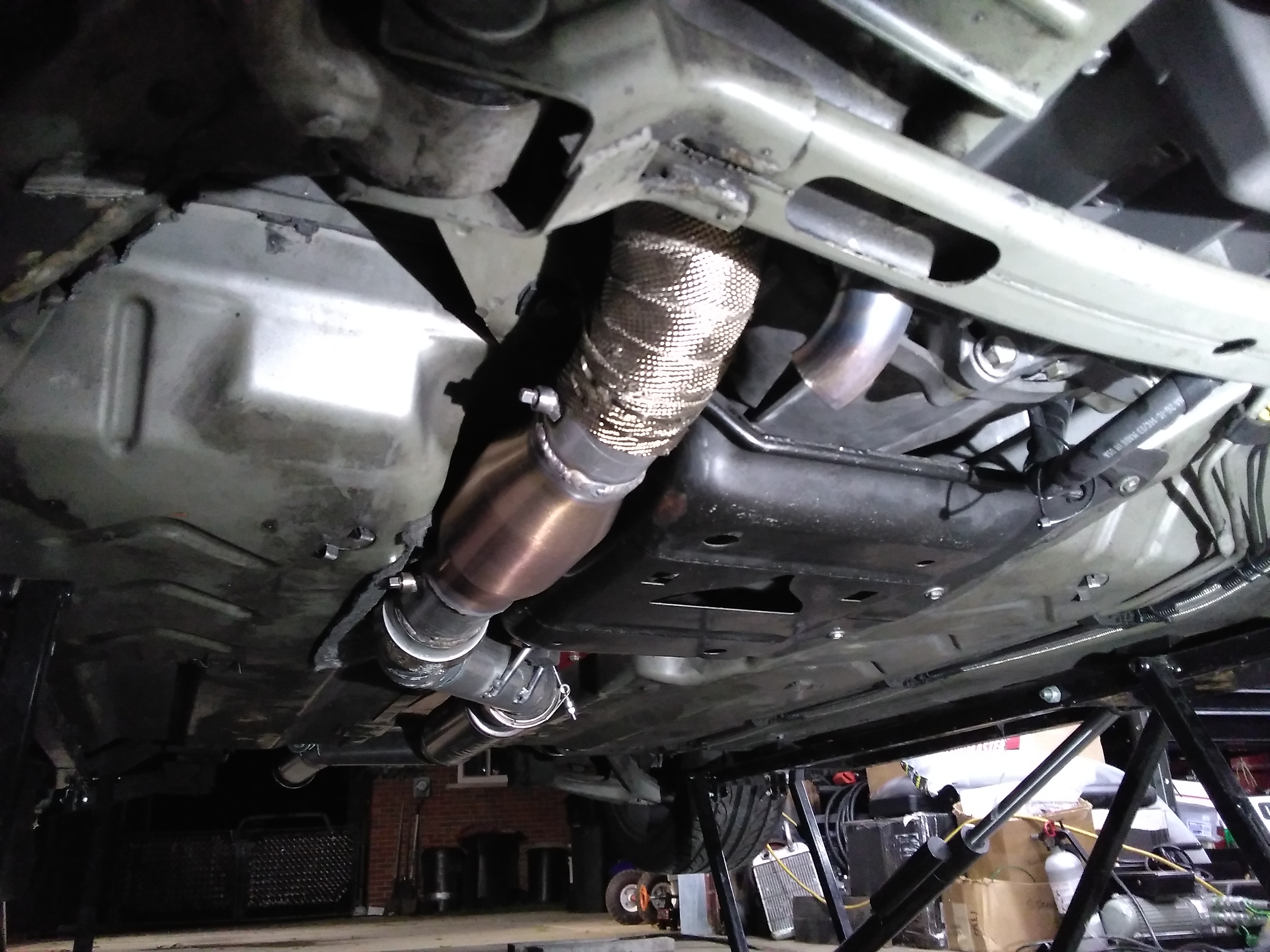

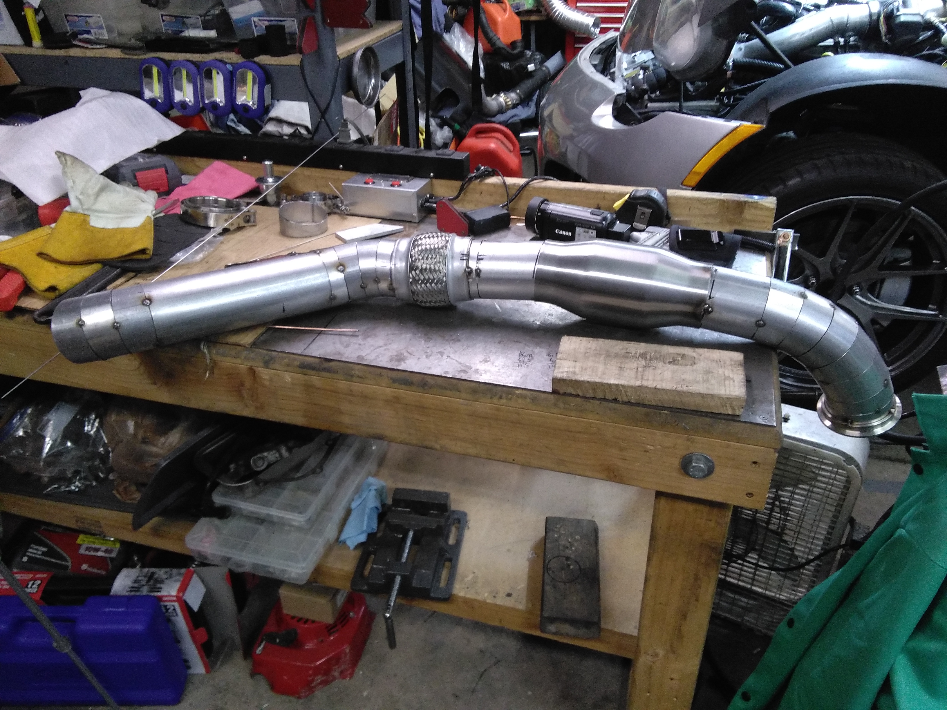

Mid-pipe fabrication in progress

Def sounds mean as hell!!!!

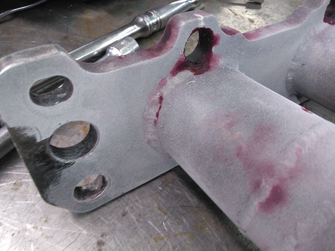

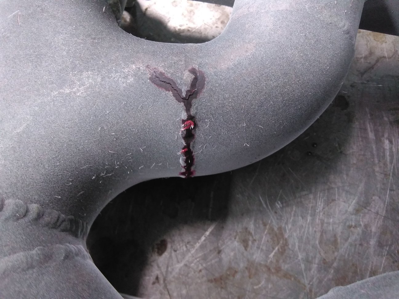

Long complicated story short:
1) Exhaust manifold cracked
2) Exhaust manifold removed and repaired
3) Exhaust manifold bolted up and then the car was immediately driven to the drag strip with 0 minutes to spare
4) Exhaust manifold stud nut backed off and caused an exhaust leak
5) Already paid to race so made 1 run, fueling was super rich and it could not make more than 13 psi boost
6) Drove home
New ARP nut ordered will try again in a couple weeks.

I ordered a new arp nut for the manifold stud and pulled the turbo, replaced the nut and got everything back together.  I still heard an exhaust leak so I figured it was time to machine the flanges flat.  I pulled everything apart again and indeed the flange needs some flattening service, but I also found some more cracks in the manifold that I missed (being a rush to fix the big crack).
This manifold was made by Werks and some folks think it is a piece of crap because it is cracking; but I disagree, this manifold has a lot of heat cycles on it and I think it is a relatively good manifold way past it's prime :idk: can't expect 100,000 miles out of a hand built race manifold just sayin
With the help from the engine builder at work, he showed me how to flatten the exhaust manifold flange with a gigantic disc sander (diameter larger than the length of the flange). I was about to buy a 6"x48" belt sander after calling machine shops who said they don't deal with stainless steel.
While I had the manifold off, I installed an NPT bung to accept a EGT probe, I put it on the cylinder 4 runner as it is the hotest running cylinder from my understanding, the EGT is about 1.5" away from the head.

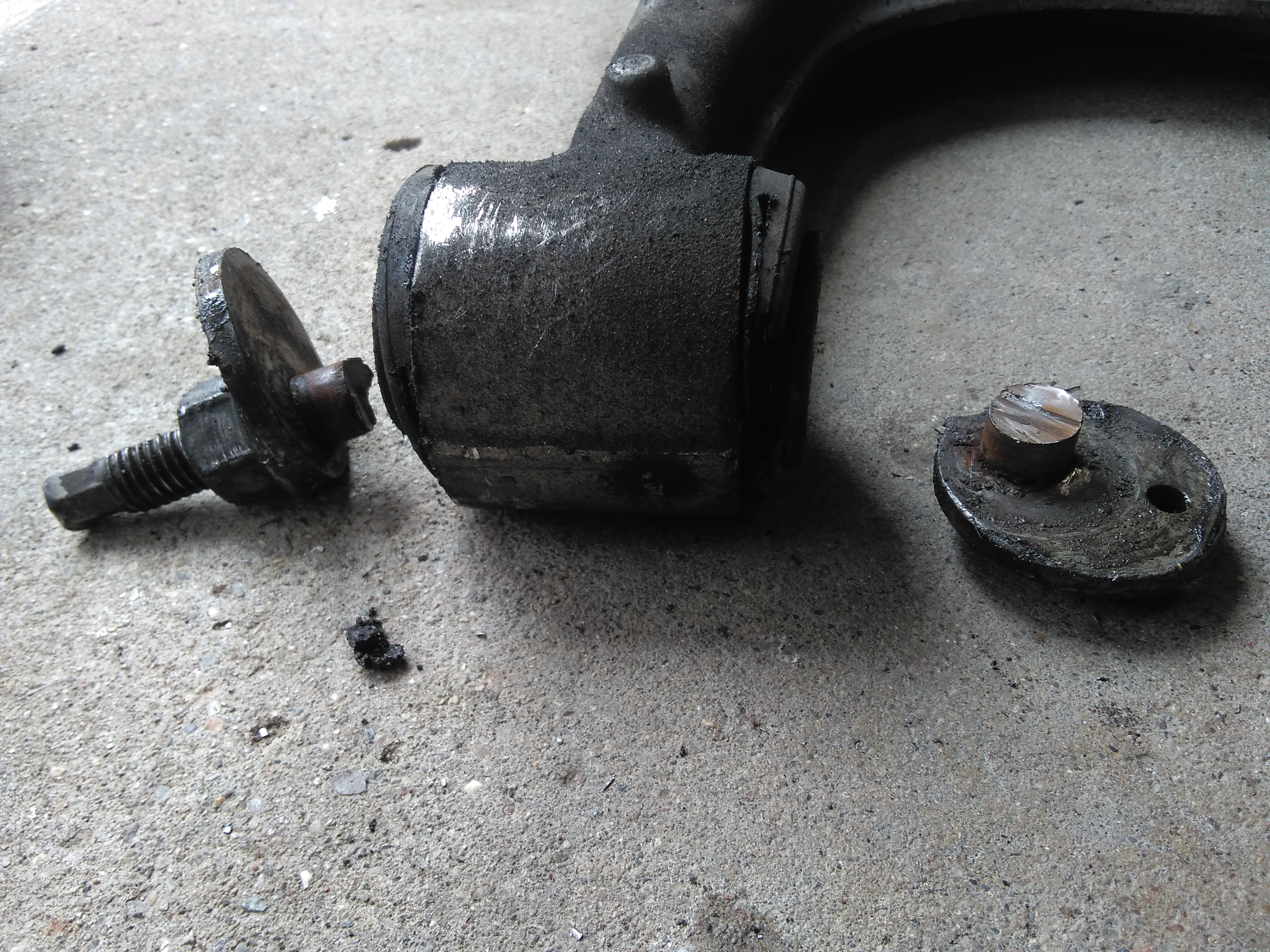

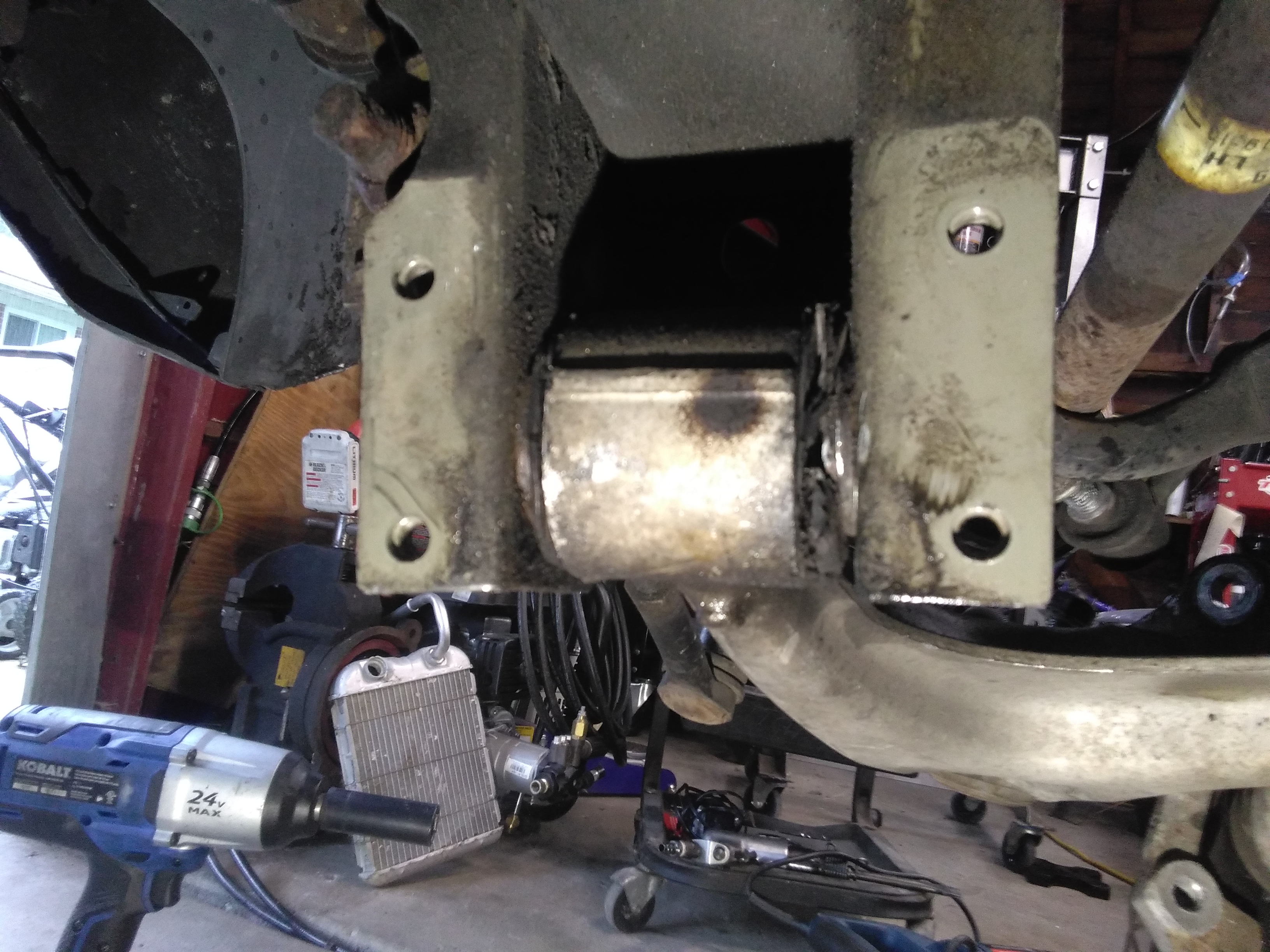

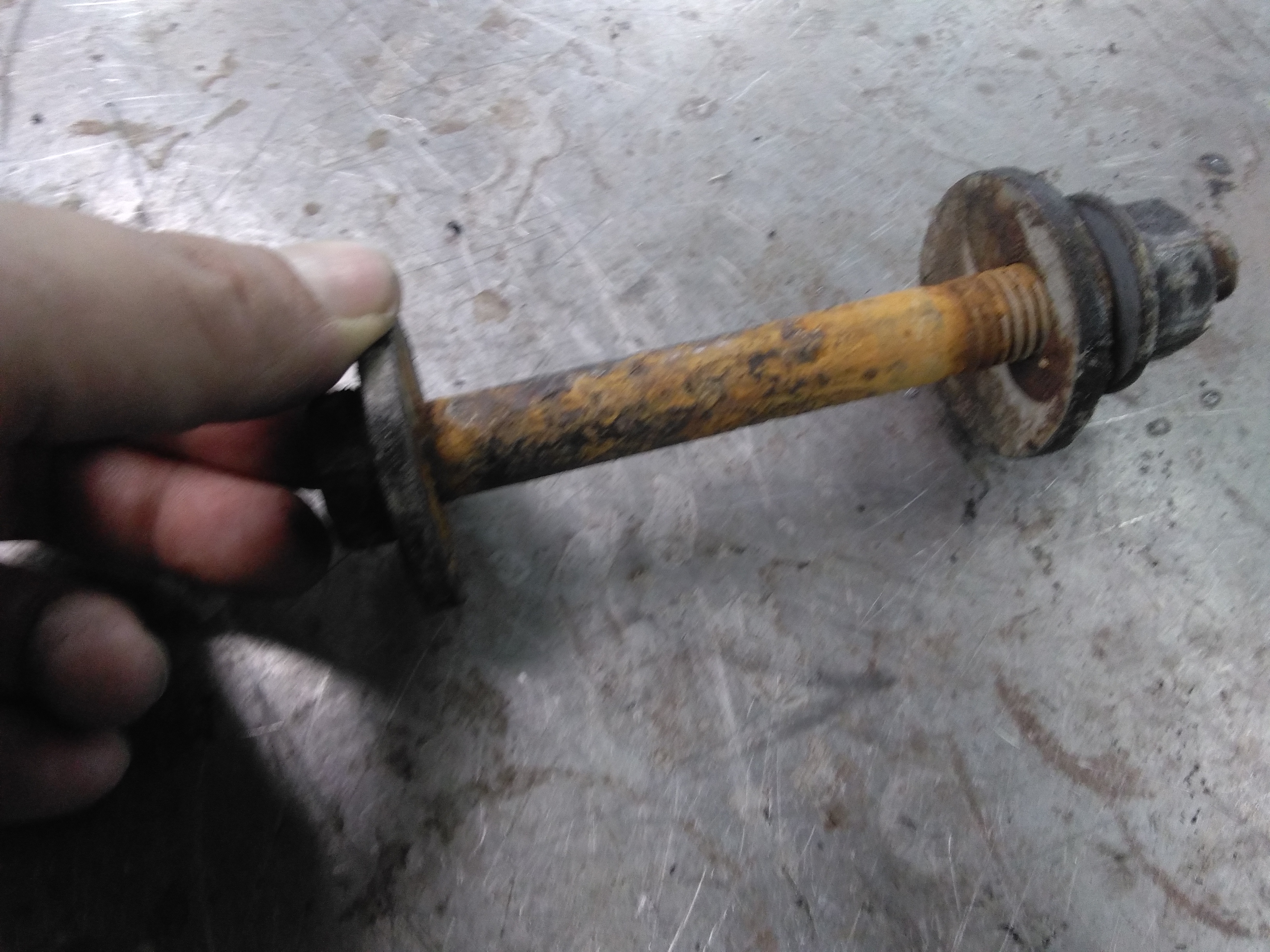

The hotside is buttoned up so the next task was to install the energy suspension rear bushings that I put off for very good reason, the job SUCKS.  I was right.
I soaked it for 24 hours with kroil, then slammed the stuck cam bolt with a mini-sledge, then slammed it with the air hammer at max pressure (with high flow fittings), hit it with the impact (which just rotated the control arm comically).  I then accepted that it needed to be cut so the sawsall was not working bending the blade, the standard grinder with cutoff wheel did not go deep enough, so I ended up using an air powered cutoff wheel (my poor 60 gal compressor).
Pro-tip: remove the reinforcement panel to give the best access to cut the bolts off.  Also, do not cut the spacer washers, you need to go through the rubber to the inside of the outer spacer washers.
Pro-tip: just pay someone to do the job if you don't have the proper tools.
*I couldn't cut all the way through the bolt, so I had to breaker bar these bolts off.
Fortunately, the passenger side came out with the air hammer method.  Look at that rust.  The rearend lower CA front cam bolts slide out by hand.

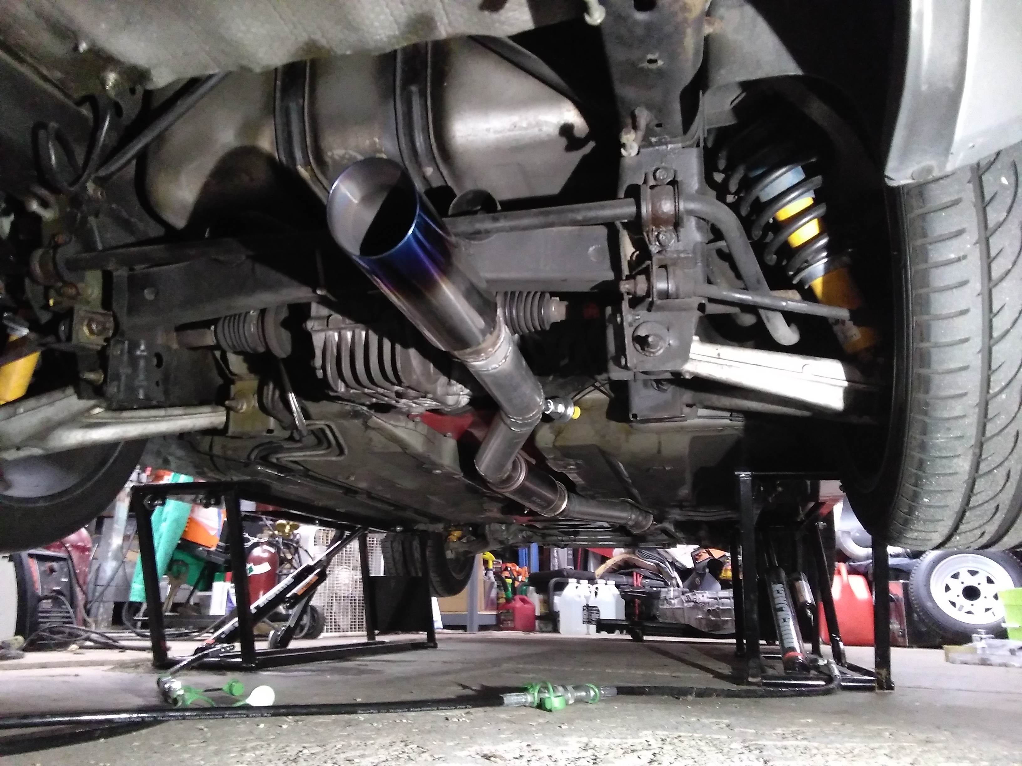

Made multiple runs at the drag strip last night could not get a clean run.  I have so many excuses it's a joke.  Least worst run was 13.2 at 109, 60ft around 2.1 with lots of wheel spin.  I am going to continue to push forward with developing this project, so hang tight for now I may try to run one last time.
