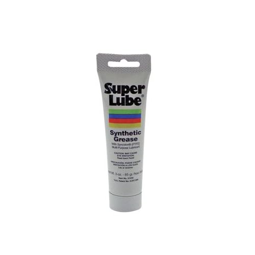

I read up on a few people that have installed the Eibach sway bar, same procedure, I think I saw mostly 2 hours some said drop the exhaust others didn't, neither one of us has a stock exhaust but mine drops in about 2 minutes just remove one band clamp, this one time at band clamp, and it's down.  Soooooo maybe if we say it will take 4 hours we can make a parts run to NAPA. I had wings at NAPA last night, I just love there headlight display, and the upholstery was very nice too.
In my never ending search for truth justice and the American way, I have discovered another tidbit of info. It would seem that GM, and the urethane bushing makers recommend that you do not use a petroleum based grease to lube the sway bar bushings, this can cause the rubber/urethane to harden and crack. They recommend a synthetic based grease with PTFE, the one they spec only comes in 5 gallon buckets, just a bit more than I need. I did find some in a smaller amount 3 ounces for $3.33 on Amazon or at Ace Hardware. It's called Super Lube Synthetic Grease With PTFE Teflon. I am now trying to find it is a grease tube for a grease gun.
« Last Edit: June 11, 2009, 12:27:58 PM by lil goat »

should we take the super lube to NAPA?

Order what, wings from NAPA and yes the lube would be good to take with us ya never know when we might need it, the GXP Z0K sway bars from GM Parts direct, the sway bar bushings from Jegs, the lube from Amazon.
