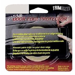

Here's a tip (sorry for the thread sidetrack)...  I got a reel of this stuff.  Basically it's just thick clear-guard in a 3/8" wide tape form.  Used it for my rear door edges to protect against any slight impacts when (passengers of course) are opening the doors.  Plus the edges of the hood and the front top edges of the doors to help protect against the two impacting there - as your obviously did.  Virtually invisible when on and cheap insurance.
I got mine on closeout from Advance Auto, but available online here (and other places): http://www.amazon.com/Trimbrite-T9023-Edge-Paint-Protec/dp/B000CQ47FG
